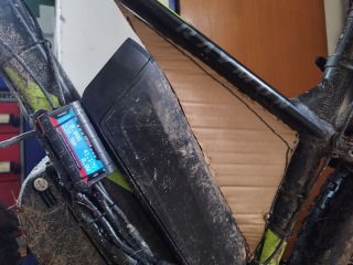

Hello everyone,
I’m running an MTB with a BBS02b motor and two 10s4p batteries in parallel (12Ah each, so 24Ah total).
At the moment, my controller can handle a peak of 63V (thanks to a BBSHD controller with custom firmware. With the stock firmware, the cut-off voltage is 60V, which is why BBS bikes usually max out at 14s batteries.)
63V corresponds to 15s fully charged (4,2V).
I want to charge the batteries to around 4.1V per cell, which gives a total of 61.5V.
The controller draws a maximum of 33A.
I’d like to keep using my existing 10s batteries since they’re still in good condition.
My plan is to add a 5s battery in series (I’m familiar with the challenges of series-connecting batteries).
The reason for this setup is that I want a mid-drive motor capable of very high RPMs when needed.
The bike is occasionally used for trial-like riding, and higher RPMs give me more peak power and reduce the need for shifting in difficult sections.
There’s some of space in the frame triangle (marked in blue in the attached image, instead of the bottle cage), and I’d use threaded inserts in the frame to mount the battery.
Here’s what I have in mind for the new 5s battery:
  • Nominal 18V (21V fully charged)
  • BMS capable of handling 33A for a few seconds, so a 40A BMS is recommended
  • At least 12Ah, ideally closer to 24Ah (it’s okay if the full 15s voltage is only available for short rides, but it’d be nicer if the 5s battery had almost the same capacity as the current 10s setup)
Since 5s batteries are not very common off-the-shelf for bicycle useage, I’d highly appreciate your recommendations and thoughts.
(Of course, the simpler and slightly less powerful alternative would be a large 14s battery. Downsides of that approach: higher cost, slightly lower voltage, less sustainable because I already have two good 10s batteries, and a slightly higher center of gravity (currently, one battery is mounted under the down tube).)

Do the two existing batteries use common port BMSs?
A 5S 24Ah battery will be as big as one of your existing batteries. Do you have room for that?.
Thanks for your feedback.
Both existing batteries have an individual BMS.
Regarding room/size of a 5s 24Ah: I would have to measure it for sure (as soon as I find a battery with the right specs). Might be possible with high capacity 21700 cells (depending on the ratio of the battery's dimensions in the three dimensions).
Common port or multiport BMSs is the question, not whether they have a BMS. If you use the wrong type of BMSs when combining packs, your packs may be unprotected under scenarios when you have a trip. At that point you’ll have the opportunity to replaced the fried BMSs or put out the fire.
A 5S 24Ah pack will contain the same number of cells as a 10S 12Ah pack when using the same cells. Your 5S pack will need to have the current capability of the two existing packs combined, keep that in mind during cell selection.
Just one opinion, but going with 15s vs a common 14s makes very little sense. You could buy a couple of cheap lipo packs, 4S and 5S and do a short test ride to get a feel for the difference. I tested 14s through 22s that way, and a 1s increment difference isn’t much unless you butt meter is super sensitive.
Thanks for the warning.
Honestly I don't know but I will ask the battery dealer about it (the 10s batteries were assembled in Germany so it might have the safer multiport BMS).

Clearly you feel it’s worth the work of swapping out your existing BMSs and building the 24Ah 5S pack to get that additional performance, so you need to select cells next. If you can match the capacity and combined IR of the existing packs, that would be ideal.
Thanks for the insightful and respectful communication.

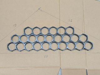

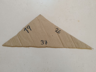

I am "designing" the 5s battery now.
I would commission a battery manufacturer to produce it (because I never did it so far and lack experience).
Available space:
Values of the triangle in centimeter.
21700 cell holders (25pcs, most probably 5s5p with 5Ah (15A nominal) LG M50LT cells (25Ah):
Just for my better understanding:
What bad things can happen in practice if the 5s pack has more capacity and a lower IR compared to the existing 10s pack (series-connection) and I only use "standard"-BMS (without special communication or without a balance board that will balance across the two packs)?
I understand that there is a huge imbalance (e.g. 5s at 20% SOC and 10s at only 10% SOC, 10s has higher procentual voltage drop under load because of higher IR).
Worst thing I can imagine that either the 5s or 10s part will be completely empty (nearly 0% SOC) and the other part is still strong - and the controller demands high current.
(Nearly) empty packs hate high current (and the standard BMS won't react to it properly - no total shut-off in time) and cells might get damaged (or in worst case catch fire).
Correct?
As long as I keep an eye at the SOC of the 10s and 5s pack INDIVIDUALLY (to avoid that the 10s or 5s pack gets empty) is there still a high risk for such a series-connection?
Please send me a link that I can read (if you have one) to close my knowledge gap regarding the real world risks of series-connection of different packs (capacity- and IR-wise) which have still a good "standard"-BMS.
