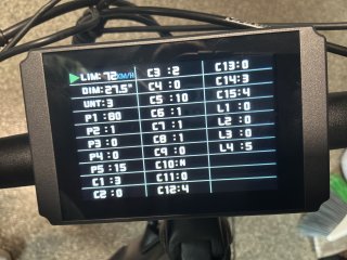

1. Can you post all of your settings?
2. Can you confirm that both motors are identical (same model and gear ratio, etc.)

I agree with E-HP that, if you really want to chase this down, post your controller settings or try swapping controllers.

P1 80
P2 5
P3 1
P4 0
P5 15
C1 02
C2 0
C3 5
C4 0
C5 10
C6 5
C7 0
C8 1
C9 0
C10 n
C11 0
C12 4
C13 0
C14 3
The motor seems weaker than my 36v 750W ebikeling motor. From the specs I looked up and after conversing with Ride1up, they have the same torque and other specs. According to them, they had bafang modify the 500w version of the motor to be wound for 750w sustained.

Try P1 = 100 and P2 = 6 and set wheel diameter to your actual wheel size and not rim size.
It should go a bit better then.
With those settings it reads as 5mph.
