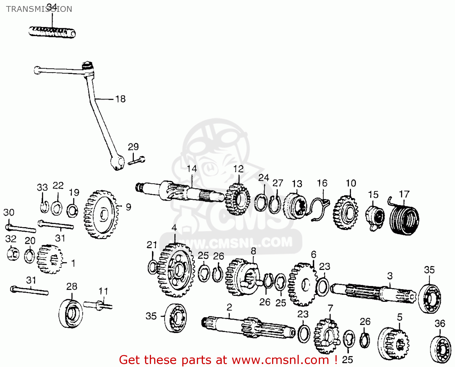

Found on CraigsList a Honda MR50 engine (2-stroke 3 speed with clutch).
The guy thinks it an antique and wants $45 for it...If it looks OK I will probably take a chance on it and see if I can separate the transmission from the crankcase (it's already mechanically separated because of the 2-stroke) and get a 3 speed tranny for the eBike.
What do you guys think???
http://www.cmsnl.com/honda-mr50-elsinore-k0-us_model681/partslist/
Heres an exploded view of the trans:
http://images.cmsnl.com/img/partslists/transmission-mr50-elsinore-k0-usa_bighu0227e1106_15bf.gif

For certain it will be a robust unit once it is re-housed or trimmed up to fit the application. In my experiance your going to fine the ratios kinda close together for ellectric motor use.
There are a few examples of guys using motorcycle trannys around the net.
Most are a little disapointed that the only viable gears were 3rd for starting out & then 5th while underway.
But you know I am a multi ratio advocate, so anything is better than nothing.
The MR50 is a collectable these days :D
Maybe a little too robust I hear you saying.
Would I be better off looking at wye to delta switching?
