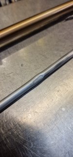

The bike is sitting idle as I took the leaking suspension to the shop, and we discovered all kinds of horrors inside:
I bought another fork (for about 200 eur) and the plan is to put the two back together into a one working unit, with my new seals and springs. Fingers crossed.

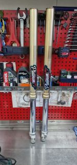

I picked up my fork back from the shop:
Look how pretty! It got assembled as a mix of parts from both forks i had (the original and the spare set). It got the 4N/mm springs and a much softer, plusher settings for the slower speed, technical riding this bike will be doing. Can't wait to try it out!
Because I got the parts from the old shocks, I decided to weigh them:
Obviously you need to add ~492g of oil to get the final 4.5kg per side.
Not sure how interesting it is, but I personally am very intrigued by how much various parts of the motorbike weigh, in the endless pursuit of a superlight e-moto.
