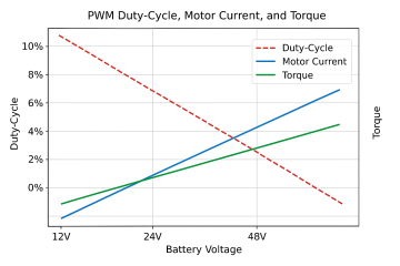

Oh, and I almost forgot, regarding the lower voltage and higher torque, I actually asked ChatGPT about that, and it gave me a diagram, which is how I came to that conclusion.
I wouldn't put trust in anyting any of the AIs tells you, unless you research it and verify it. They don't "understand" anything, and while they are often right, they are also often ridiculously wrong, or provide an answer that sounds perfectly logical but does not apply to the question you want answered...only the question it interpreted from your words. ;)
The graph doesn't label anything for the motor current line, but one must assume it goes up toward the right, because torque does, and torque is proportional to current. This graph thus shows you that motor torque goes up with motor current, which goes up with motor voltage (not down).
The duty cycle they're talking about is probalby for a brushed DC motor, which is directly controleld only by PWM. A multiphase BLDC motor is more complicated than that--voltage still increases current, but commutation (spinning) is done electronically, not simply by voltage applied (direct or average).
What the chart shows is that for a given *battery fvoltage*, less PWM duty cycle is needed to get the same motor current, and thus motor torque.
So...torque still goes up with voltage because current does.
I recommend strongly to go to the ebikes.ca motor simulator where you can experiment with many setups and see how they work under various "real" conditions.

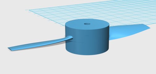

As an alternative to the existing propeller i modified a OpenSCAD code i found on thingiverse.

CenterlinePosition = 40; // Position of rotation axis in profile; [25-45]
/* [Material Strength & Root Optimization] */
ThicknessFactor = 1.15; // Increase for stiffness; [1-1.5]
ThicknessFactorAtBase = 35; // Reinforcement at the root; [3-6]
BaseBladeThickeningLength = 0.33; // Length of root reinforcement in % of r; [0.2-0.4]
ThicknessFadePower = 1.8; // Curve shape of transition (1=Linear, 2-3=Smooth/Organic); [1-5]
RootAsymmetry = 0.3; // Asymmetric thickness (0.1=Massive nose, 0.5=uniform); [0.1-0.5]
ChordFactorAtBase = 2.5; // Factor for chord length at the root (1.3 = 30% wider); [1-2]
BaseChordThickeningLength = 0.35; // How far the widening extends radially (in % of r); [0.1-0.5]
ChordFadePower = 2.5; // Curve shape of widening (2.0 = S-Curve); [1-4]
MinEdgeThickness = 0.7; // Minimum thickness of trailing edge; [0.2-0.4]
MinEdgeThicknessRoot = 1.2; // Minimum thickness of trailing edge at root;
EdgeThicknessFadePower = 2.2; // Decay rate of root trailing edge; [1-3]
RootInsetFactor = 0.28; // Immersion depth into HUB; [1-20]
/* [Hub & Nose Cone] */
HubDiameter = 70; // Hub diameter;
HubThickness = 130; // Hub length;
HubOgiveZOffset = -105; // Shifts Hub on Z; [-50--70]
OgiveFlip = 1; // Rotates Ogive by 180°; [0=false, 1=true]
OgiveShapePower = 2.8; // Shape of the Ogive; [1.5-3]
ShaftDiameter = 0; // 0 = solid
/* [Profiles] */
NACA1 = [4,4,13]; // Profile at the root; [thicker]
NACA2 = [2,3,9]; // Profile at the tip; [thinner]
MaxThicknessPosRoot = 0.35; // Location of thickest point at root (0.3 = 30%)
MaxThicknessPosTip = 0.45; // At the tip (0.4-0.5 is good for efficiency)
CamberFadePower = 1.5; // 1.0 = Linear, 2.0 = Camber remains high longer on the inside
// LOGIC-CORE
$fn = $preview ? 32 : 128;
Diameter = DiameterMM;
HubRadius = HubDiameter / 2;
EffectiveHubThickness = max(HubThickness, MaxChordLength * 1.0);
AF_terms = [0.2969,-0.1260,-0.3516,0.2843];
a4 = -0.1036;
s = 30;
AirfoilWidth = 1000;
function T_r(r)=((NACA2[2]-NACA1[2])*r+ NACA1[2])/100;
function AirfoilHeight(r) = AirfoilWidth * T_r(r);
function GetLocalPitch(r) = PitchMM * ( PitchRootFactor + (PitchTipFactor - PitchRootFactor) * r);
function CenterlineAngle(r) = BladeSweepFinalAngle * pow(max(0.0001, r), SweepCurvature);
function CenterlineOffset(r) = let(ang = CenterlineAngle(r)) BladeSweepFinalAngle != 0 ? -(ln(max(0.0001, cos(ang)))) / (BladeSweepFinalAngle * PI / 180) : 0;
CenterlineLength = sqrt(pow(.5*Diameter,2) / (pow(0.5*CenterlineOffset(1),2)+.25)) / 2;
function BladeThickness(r) =
let(
baseT = ThicknessFactor * AirfoilHeight(r) * (ChordLength(r)/AirfoilWidth),
tipTaper = (r < 0.7) ? 1 : 1 - ( (1 - TipThicknessFactor) * (r - 0.7) / 0.3 )
baseT * tipTaper;
function BladeHeight(r) = BladeTipHeight * pow(max(0, r), BladeCurveHeight) / CenterlineLength;
function RollAngle(r) = atan( (BladeTipHeight/CenterlineLength) * BladeCurveHeight * pow(max(0, r), max(0.01, BladeCurveHeight-1)));
function ChordLength(r) =
let(
baseShape = RootWidthRatio + (1 - RootWidthRatio) * sin(r * 180),
distortedShape = pow(max(0.01, baseShape), BladeFormSymmetry),
standardChord = distortedShape * MaxChordLength,
chordBoost = (r < BaseChordThickeningLength)
? 1 + (ChordFactorAtBase - 1) * pow(1 - (r/BaseChordThickeningLength), ChordFadePower)
: 1,
boostedChord = standardChord * chordBoost,
safeR = max(TipStartPoint, r),
taper = (r < TipStartPoint) ? 1 : 1 - (TipRoundness * pow((safeR - TipStartPoint) / (1 - TipStartPoint + 0.0001), TipCurveShape))
max(0.1, boostedChord * taper);
function PitchAngle(r) = atan(GetLocalPitch(r)/(2*PI*max(0.0001, r)*CenterlineLength));
module AirfoilGeneration(r) {
camberFade = 1.5;
M = (NACA1[0] + (NACA2[0] - NACA1[0]) * pow(r, camberFade)) / 100;
P = (NACA1[1] + (NACA2[1] - NACA1[1]) * r) / 10;
T = T_r(r);
localChord = ChordLength(r);
mTP_Root = 0.35;
mTP_Tip = 0.45;
currentMaxPos = mTP_Root + (mTP_Tip - mTP_Root) * r;
p = ln(0.3) / ln(currentMaxPos);
rootBoostRange = BaseBladeThickeningLength;
localRootBoost = (r < rootBoostRange)
? pow(1 - (r/rootBoostRange), ThicknessFadePower) * (ThicknessFactorAtBase - 1)
: 0;
currentMinEdge = (r < rootBoostRange)
? MinEdgeThickness + (MinEdgeThicknessRoot - MinEdgeThickness) * pow(1 - (r/rootBoostRange), EdgeThicknessFadePower)
: MinEdgeThickness;
actualMinEdge = min(currentMinEdge, localChord * 0.05);
AirfoilX = [for(i=[0:s]) 1 - (1 - cos(i * 180 / s)) / 2];
polygon(points=1000 * [for(i=[0:2 * len(AirfoilX) - 1])
let(
isUpper = (i < len(AirfoilX)),
idx_real = isUpper ? i : (2 * len(AirfoilX) - 1 - i),
x_orig = AirfoilX[idx_real],
x = pow(x_orig, p),
xWeight = pow(1 - x, 1 / RootAsymmetry),
currentBoost = 1 + (localRootBoost * xWeight),
yc = (x < P) ? (M / (P * P)) * (2 * P * x - x * x) : (M / ((1 - P) * (1 - P))) * (1 - 2 * P + 2 * P * x - x * x),
dyc_dx = (x < P) ? (2 * M / (P * P)) * (P - x) : (2 * M / ((1 - P) * (1 - P))) * (P - x),
theta = atan(dyc_dx),
thickness = (T / 0.2) * (AF_terms[0] * sqrt(x) + AF_terms[1] * x + AF_terms[2] * x * x + AF_terms[3] * pow(x, 3) + a4 * pow(x, 4)),
finalThick = (thickness * currentBoost) + (x * (actualMinEdge / max(0.1, localChord)) / 2) / (T / 0.2)
isUpper
? [ x_orig - finalThick * sin(theta), yc + finalThick * cos(theta) ]
: [ x_orig + finalThick * sin(theta), yc - finalThick * cos(theta) ]
module HubOgiveBody(L) {
rotate_extrude($fn=100) polygon(concat([[0,0], [HubRadius,0]], [for(i=[1:40]) let(t = i / 40, r = HubRadius * (1 - pow(t, OgiveShapePower)), z = L * t) [ r, z ]], [[0,L]]));
module HubSelector() {
L = EffectiveHubThickness;
translate([0,0,HubOgiveZOffset])
if (OgiveFlip == 1) rotate([180,0,0]) translate([0,0,-L]) HubOgiveBody(L);
else HubOgiveBody(L);
module BladeSlice(r) {
chord = ChordLength(r);
translate([CenterlineOffset(r)*CenterlineLength, BladeHeight(r)*CenterlineLength, r*CenterlineLength])
rotate([-RollAngle(r),CenterlineAngle(r),-PitchAngle(r)])
linear_extrude(height=0.05) translate([-CenterlinePosition/100*chord,0])
scale([chord/AirfoilWidth, BladeThickness(r)/AirfoilHeight(r)]) AirfoilGeneration(r);
module Blade() {
ChordRoot = ChordLength(0);
RootSweepAngle = CenterlineAngle(0);
LE_radial = abs((CenterlinePosition/100 * ChordRoot) * cos(RootSweepAngle));
Gap_LE = HubRadius - sqrt(max(0, HubRadius*HubRadius - LE_radial*LE_radial));
TE_radial = abs(((1-CenterlinePosition/100) * ChordRoot) * cos(RootSweepAngle));
Gap_TE = HubRadius - sqrt(max(0, HubRadius*HubRadius - TE_radial*TE_radial));
localRoot = (HubRadius - (max(Gap_LE, Gap_TE) * RootInsetFactor)) / CenterlineLength * 0.98;
for(i=[0:Sections-1]) {
r1 = max(0, localRoot) + (i/Sections)*(1-max(0, localRoot));
r2 = max(0, localRoot) + ((i+1)/Sections)*(1-max(0, localRoot));
hull(){ BladeSlice(r1); BladeSlice(r2); }
module main() {
BladeInstances = (ShowSingleBlade == 1) ? 1 : BladeNumber;
difference() {
union() {
if (ShowBlades == 1) {
for(i=[0:BladeInstances-1]) {
rotate([90, 0, i * 360 / BladeNumber]) Blade();
if (ShowHub == 1) {
HubSelector();
union() {
if (CutHub == 1) {
translate([500 * (CutSide == 1 ? -1 : 0), -500, -500])
cube([500, 1000, 1000]);
if (ShaftDiameter > 0) {
translate([0,0,-500])
cylinder(h=1000, d=ShaftDiameter, center=false, $fn=50);
if(Clockwise != 1) mirror([1,0,0]) main(); else main();
Greetings from Germany
