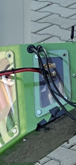

During this 5 years I personally modified my ebike.
Most of modifications was done around charging capabilites. Replacing generic bms by ANT 150/50 bms. Also I tested about 10-12 different chargers and (I ended with 2400W moded rectifier for trips bcoz of size and light weight) I had also r4850g but it was very loud and hot even at low power
Story of charge ports:
- XLR (5A at first, later 10-12A - at 10A it was very very warm)
- XT60 (25-30A)
- DUAL XT60 (25-30A + 26A) my record of charging speed - total was about 55-56A - 20-90% under 20minutes with total of 4 chargers connected in parallel
- silver high amp (30A) socket (didnt remember name exactly)
and FINAL and IMO best charging port:
- anderson 50A, i know its BIG but this is advantage - its easy to plug in comparasion to xt60
I also modified my rectifier for better look (I broke my leg in summer so I HAD TO do something)
Next mods in 2025 - new wiring insdie and outside for better look.
Genuine andersons do a great job for stuff you don't mind being big; they stay connected when they should, and have the sacrificial tips so sparks don't damage the conducting surfaces. :) You can also get housings that are pre-keyed in various ways so that if you have multiple things with them on there, you can't accidentally plug the wrong ones together. ;)
Is this
3D printed? If so, would you be willing to post the file for it? There's probably a number of people that use the SB series andersons for charging that would appreciate being able to have a "handle" housing for it. (my charger is built into the SB Cruiser trike so I don't need a handle like that, but there are others that could use it).
Nice and clean. But the crankset looks kinda out of place, like it's there just so the thing can pass as a bicycle. Foot pegs would match it better.
handle I downloaded some time ago:
inlet for anderson is custom (I try to upload file later)
its not fit perfectly - bcoz I didnt know how to draw this* in 3d, so I printed smooth version of it and connect by 4 self tapping screws - its rock solid
