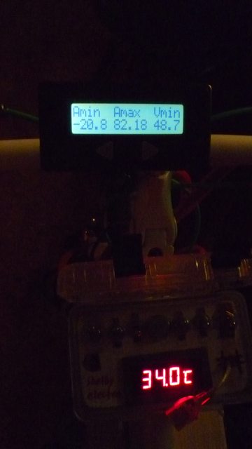

I'd like to apologies for a glaring mistake I made. I said a 48v kit was only capable of putting out 40 amp peaks, but I was quite wrong. I didn't set up parameter designer correctly because of a dumb mistake I made. At 48v my bike was able to easily put out 67amps. I did this with the BMS bypassed.
I don't know where the 82amps or the vmin of 48.7v came from. It was pulling 67amps and the voltage was sagging down to 49v. Of course as soon as I got up to 26mph the amp draw drops down to like 15-20amps. Even going up a slight hill, with a head wind, and speed %120 enabled the amp draw was only near 30 amps. I guess what I meant to say is that even with a 1c ping, the voltage sag is only 3v at 3c and 2v at 2c. It's not great, but totally fine for just about everyone. A 15ah ping pack would be fine for stock controllers!
That 82.12a draw happens when you first hit the throttle at 0rpm; probably occurs for a matter of milliseconds.
Told ya so.. that's why you suddenly need to get torque arms quick.. ;)
Yes, one characteristic of DD motors is that they have a pretty typical electric motor power curve; they will eat as much juice as you can give them at 0rpm then level out until they see resistance ( like hills for example ).
Geared motors on the other hand, seem to draw maximum amps almost all the time. Instead of pooping out at higher speeds, they tend to just keep dumping as many amps as the current limiter will allow.. interesting characteristic. The only reason they are more efficient overall is because they require less amps and volts to do the same job, so the power usage does even out.
This is why am always running around recommending people buy a battery based on the nominal discharge rate and not the 'burst' rate. You want that long cycle life they advertise? run it at the nominal discharge rate that the 1000-3000 cycle count is rated at.
I bet your ping cells are not happy about being ran at 3-C 4C for any given amount of time. Give it a hill climb test and see if the batteries get hot. I bet they will be warm to the touch, at the least.
