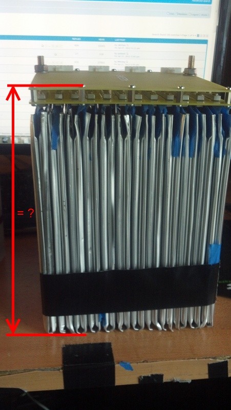

agniusm said:
Hi. Should fit. Here are 2 6s compared to panasonic pack with dimensions:http://www.endless-sphere.com/forums/viewtopic.php?f=14&t=48370&hilit=panasonic&start=100
For all dimensions check first page of this thread
thank you for the infos. Is this overall length with plate from the kit, or only the lenght of cell?
i would be happy if you can confirm this measurement please:
do i need cells with long or short deflectors for your kit?
no soldering necessary - only clamp with screws - right?
cheers
I think in real the cells are a bit shorter due to the folded foil around - or i am wrong with this?
225mm (cell) + 2mm + 14mm (kit) = 241mm -> will not fit in peli 1200 csae
it would be very nice if you could measure the pack length for comparison
Even if it would, battery terminals would need to be changed to something that fits inside the plates. Then you need some compression and some protection for pouches. I would better think of custom case from aluminium.
