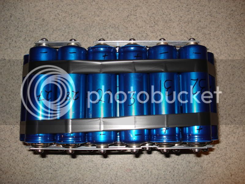

I just got 32 38120S cells in the mail. I spent the better part of two weeks now, figuring out what I wanted to use to connect the cells. My options ranged from copper flat stock, to making lots of little jumper wires with soldered eyelets.
It finally dawned on me that this is a bicycle, and that I should do my best to minimize weight. Even though the motor weighs 25lbs. :roll:
So, I decided to try some inexpensive aluminum flat stock from Lowes. It is 1/16" x 3/4". I bought three 3' pieces for about $10.
I spoke with the electrican, and he said that for aluminum, a 4ga wire is best. So, I figured the 3/4" wide stock would be as equivalent. He conquered.
Anyway, I'm going to try the aluminum stock to keep the weight down, and still keep my conductivity level as high as possible to pull up to a continuous 50amp draw at 48v.
pics will follow.

Aluminum is resistive. As metals go, its a poor conductor, even without the corosion and fire dangers Gogo refered to. Under the right conditions, you might turn the aluminum jumpers into heating elements.
But the real issue is the inneficancy of aluminum. 77% compared to 98% for copper.
Considering that your weight plus the bike, battery, and motor will likely fall between 200 to 300 pounds, how much efficancy are you willing to lose to shave an ounce or two off the total weight?
I would prefer copper, but I really don't have access to the size of bars I want for connectors.
Is aluminum more resistive than copper? Yes.
However, when using the equivelant of 4ga wire for my connectors, it will offer similar resistivity to a 6ga copper connector. It will also be lighter. I just have to make sure I score the outside layer to get good contact. I spoke with an electrician about this, and he agrees it would work just fine, if not better because it's easier to work with for drilling holes, and lighter than copper. As far as performance goes, the the 4ga equivelant will make any resistive questions a non-issue.
However, I could end up being totally wrong, and the dang thing could practically explode in my face. :mrgreen:
An Aluminium surface exposed to air forms a thin layer of resistive oxidisation only milliseconds after scoring. In order to get reliable conductivity at a compression joint, the use of lock washers which penetrates into the Aluminium surface is essential. As the teeth of the lock washers cut into the surface, they form an air-tight seal held under the torque of the bolt compression which will maintain conductivity long term, even when submerged under water. All Alluminium/steel chassis mains voltage appliances use lock washers at earth connection points. It is mandatory to comply with safety standards.
I think your weight saving aluminium idea is sound. You could even double the cubic volume of the Aluminium cell connecting strips and they would weigh less than copper strips weighing half its volume and provide minimal resistance.

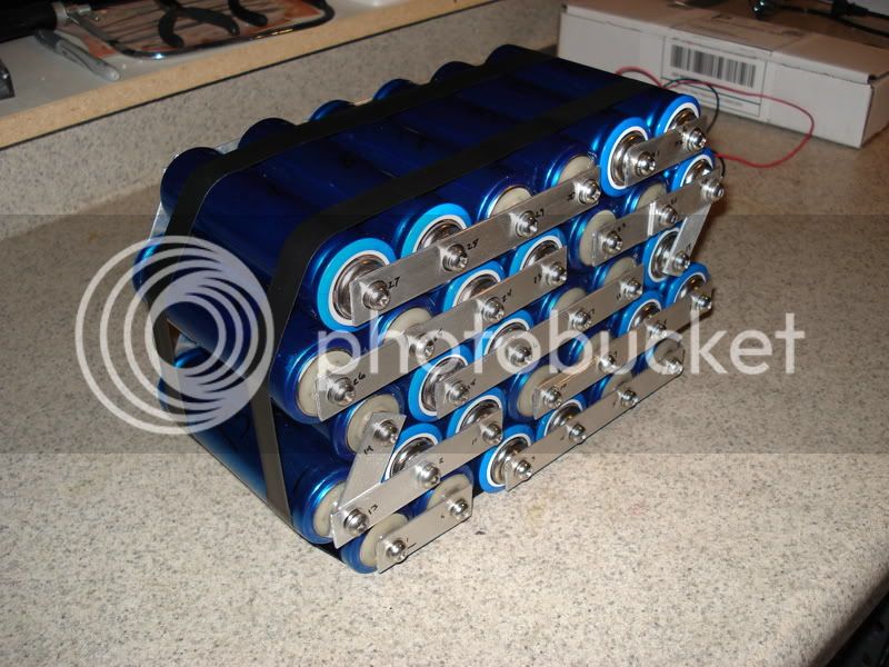

I looked for the copper strap at my local hardware store, and couldn't find any. No matter, I just got done building the battery, and I still need to wrap it. Overall it looks good. Hopefully I won't have any problems with the aluminum connectors.
My electrician said I could easily get away with using the SS split washers instead needing to buy a bunch of the washers with teeth. He said, just sand it good to a shiny finish to get the best connection possible, and it will be fine. Also, making sure I give it really good torque when I finally get the BMS leads attached is vital, because that really is when it gets the best continuity between cells. Right now, it's just assembled with the screws being snug to hold it together. I'll take some pics and post them on here.
My new battery!!! :mrgreen:

If you'll notice in my pics, the spots where the connectors double over to connect to the next row of cells above them, add up to 1/8" thick. The bars are already 1/16" x 3/4" wide. They are quite stout, and are equivalent to more than a 4ga wire, which gives me even more continuity than the rolls of copper straps with holes in them shown in the other pics. I got about 14 extra SS screws that are 10mm long to accomedate for the extra thickness. They have a much lower chance of getting snapped or stripped from assembly than a single fine 6mm stud.

As it is, my 48v/20ah pack of 32 cells, with all of the aluminum connecting bars, comes in it at almost exactly 24lbs.
