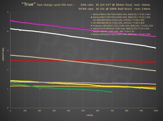

High Power Charging test (3C-3C continuous charge & discharge )
note: the test is performed at voltage ranges equvalent to 100% nominal capacity DoD

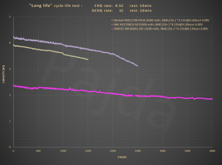

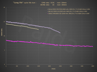

"Long Life" cycle life test
comparison of cells optimised for low cost & long life with modern HE/HP cells

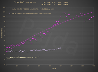

- each 50th or 100th cycle is inserted datasheet nominal capacity test with 10s DCIR test

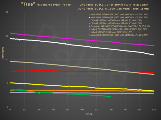

3C-3C cycle
added Moli P50B, P45B (and another LFP sample from LithiumWerks/A123 in 26650 format)
- We can see that a true 20 minute fast charge (0-95% SoC) is not a problem for modern cells.
- Both, Moli P30 and P45 hit 60% SoH at about 1,300 cycles.
- Moli P50B so far shows that the only tax for higher capacity/energy density is much higher price
- For both LFP samples from LW, the first 1,000 cycles were only a warm-up lap, the same for LTO sample.
Long life
- DMEGC finished 4,000 cycles (btw. its test was launched on October 13, 2022)
- BAK CG begins to fade after 2,000 cycles

I didn't notice until now, but holy crap. The P50B doesn't give ANY crap about high power charging when it comes to IR.
It keeps trucking on and on.
With a much better charging algorithm than CCCV, it could probably truck on for a very long time at these power rates.
updated data for both 3C-3C Fast charging cycle-life and "long-life" in the first posts.
Fast charge:
-Molicel P50B shows slightly better cycle-life performance than P45B in fast charging cycle. I will continue with cycling to see if it can surpass the 1300 cycle mark where the P45B and P30B ended.
Long life:
- BAK CG50 was ended at 2500 cycles.
- Added Molice P45B to see how it performs in low power apps.
