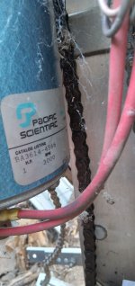

The motor and gearbox, which is huge (the size of my thigh) and probably weighs 50lbs. It's brushed, capable of up to 80A at 12v. It would be very simple to drive (I have a small old curtis golfcart controller that runs on 24-36v, if I wanted to use a low-voltage system; I could gear up the output for more speed because I am certain this thing has more torque than I could use withotu mangling the drivetrain or frame. :lol: But...50lbs.... :( Would be tempting otherwise. Could even run it controllerless and just use contactors to switch cells in and out like some of the old forklifts used to do...it has at least three or four contactors already in the electrics box. I
20250217_145659.jpg20250217_145709.jpg20250217_145726.jpg20250217_154913.jpg20250217_154929.jpg20250217_155833.jpg
Only 20 pics per post so

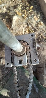

last pic of the lift arm shaft, showing it in comparison to the trike frame nd the diff, etc.
the motor has a big thick aluminum plate that it mounts to, welded to one of the aluminum box tubes.
This is the dog clutch and sprocket.

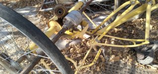

I dug out more drivetrain potential parts, including a matched pair of 1/2"-chain sprockets (which if they were the other size I'd be able to use for the rear wheels),
and I also setup a mockup of the trike with the powerchair lift bed as the cargo area, just to test fit things and get a potential idea of the layout. In the process of doing that I got the handlebars and fork and fenders off, and temporarily bolted the trike rear frame to it's front frame.
It was way easier than ever before to get those parts off. On anything that's sat outside for even a few years (much less decades like this trike) I've had to hammer, pry, finagle, and generally cuss-out handlebar quills, seatposts, steerer nuts, etc, but none of these were rusted shut, and only even had a touch of any rust on them at all. Just had to loosen the fasteners (which itself was so easy it was like I had just put them together for the first time immediately prior....).
One trick I used getting the fenders off was to use a short bit and stick it all the way into the chuck, so I didn't have to deal with the flatblade sliding off / out of the slotted screwheads (the chuck itself sits over the screwhead that way, and keeps it in place).
I keep not ending up using this biog DD-hub type powerchair motor, but this trike would be a good use for it; easier to mount than a hubmotor, but similar speed and torque output. Heavy though.
There's also an old treadmill motor; this was the first motor i'd intended to use on CrazyBike2 but went with a brushed geared powerchair motor instead.
I have at least a couple of the wheels shown there that have the removable spindle to go on the gearbox output shafts, they would fit on at least the schwinn's original diff axles, so could b eused to bolt sprockets to. Can probably bore them out for a larger axle if necessary.

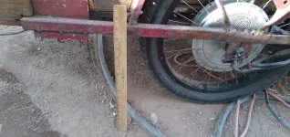

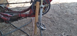

The basic layout, though it needs to be shorter; the seat neesd to move forward, so once I remove the trike's basket-holder frame (where the seat is now), and make a subframe to hold the seat and build a lockable cargo box area under the seat, the cargo bed can move forward a few inches (and thus the rest of the rear end). Total length should be close to that of the SB Cruiser, but probably several inches longer, maybe even a foot. Should end up at least 3" lower to the ground than SBC, at pedals and cargo deck base. If I use the full lift bed it'll be wider by at least several inches than SBC; that's a potential problem getting thru certain places with it (though it would make it more stable in turns, etc). There are some "rails" I can put on the sides of the deck, and a ramp that was part of the lift bed that can become the tailgate 9and still bea ramp). Or I can bulid the entire rear end out of steel square tubing, and use a wooden deck, with those rails on the sides. Either way I then have to come up with a covering to enclose it, preferably removable (as SBC's was intended to be, but I ended up making it permanent, which precludes it carrying tall stuff, so requireing a trailer for those things). ingore the buckets holding up the lift bed.
20250223_165719.jpg20250223_165726.jpg20250223_165033.jpg20250223_165733.jpg20250223_164602.jpg20250223_170255.jpg20250223_163714.jpg20250223_163732.jpg20250223_165056.jpg
Not all the pics will fit in this post, so the rest are by themselves in the next one. but below are a comparison pic of sbc, and in the next post are measurmeent comparions of the deck level and the crank height
leftover pics from the above post comapring crank and bed hieghts.
