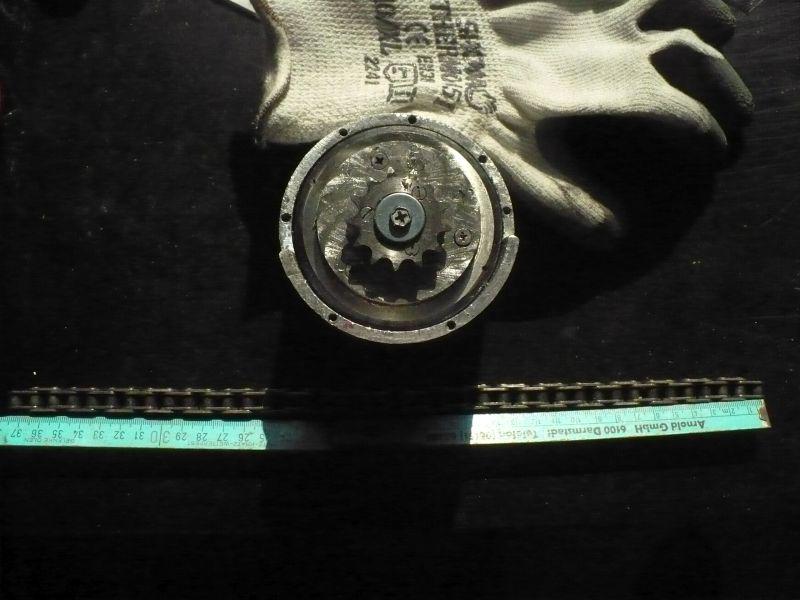

I also shortened the Tongxin by one centimeter:
As you can see all the holes, I tried hard to radially fasten the tongxin with M4 screws and get the chain aligned. It worked so bad I cannot recommend at all. I thought, there are so many on endless-sphere who did it similar, it just has to work. It does but not very long, since it's not stiff enough. The green plastic spacer I made, sucks. It was just a bad idea. When I got the new sheets done ( I ran out of alu alloy :( ) , I will post the plans for everyone whos interested.

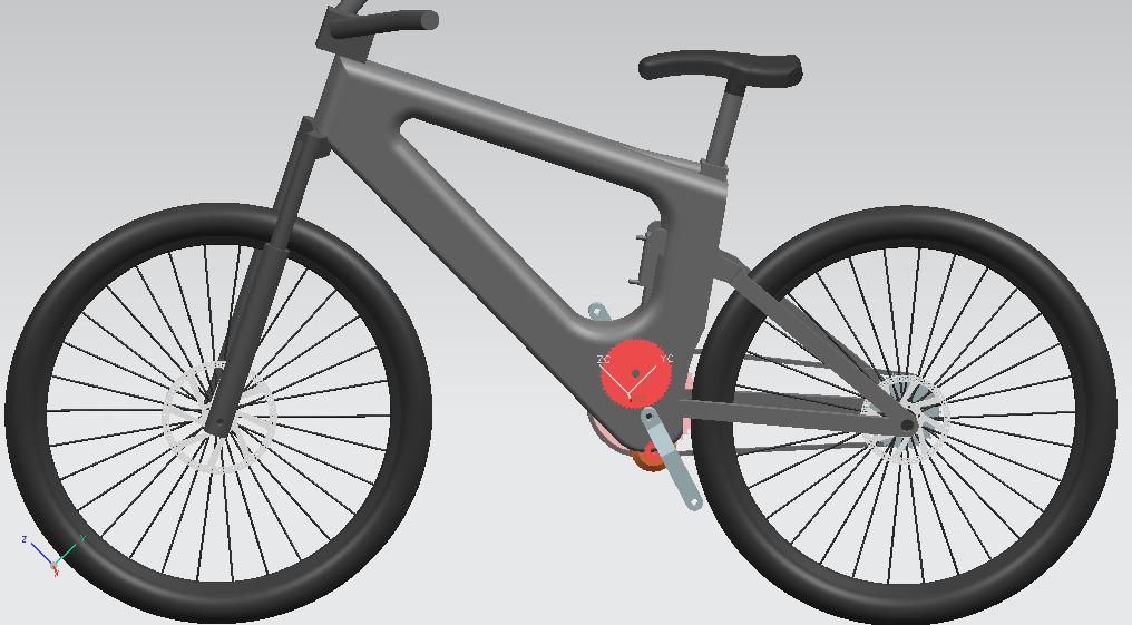

the motor could be mounted under the bottom bracket, the hubgear above. Inside the frame. I imagine a two sheet design like the tripendo (http://www.tripendo.com/) with blended edges. Wouldn't that be a beauty without an cables boxes mounted to the frame etc...
Such a frame souldn't be to hard to make if one has a good master plate like a great existing conventional frame 8)
