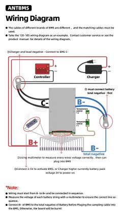

For sale by ICgogogo ,any reviews, on seller or bms, is it the latest model.? I am going to use it with 24s kokam cells and 8kw hub motor and fardriver 96850.
I’m not sure I understood you question but this antbms version don’t have on/off button, you need to power it on using 3.7v. Bellow a picture:
When I use the 24s version with 2,5cm height I use the on off button the bms have. On thin 24s antbms (your version) I never turn off the bms once installed.
Yes the one on the picture have a switch, the antbms slim versions that I have all require 3,7v.
on bms with switch I usually have hidden switch to completely disable the battery when I want. Yes the switch will disable output and everything else including Bluetooth and cell monitor.
