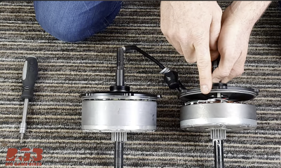

Well from my research, that bafang hib 36v 250w you laced up, is the exact same motor they also state 48v 500w magnet size with the 9-pin julet. The actual motor case size is the same with all of these, including the G062, with the only outer difference being the 3 different higher current cables they use, but no copper would notice that.
The inner difference would be bigger magnets but you can't see that! lol
Here's a pic of the G062 on the left vs their 36-48v 250/500w G060 innards if anyone is wondering. I also assume the 1000w to be the exact same as the 750w which would make sense from a manufacturing perspective.

Same with cars nowadays all built on the same platform but a different dressing on top.

Same size case as the 250w version just heavier..
