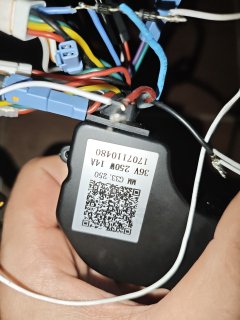

Hello. I have a bike with bafang g33 250w uart and it has an aftermarket battery with only two wires positive and negative. The original battery had positive negative and 4 more thin wire for communication with bms i guess whitch are now left isolated.

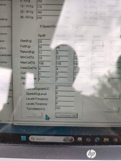

The problem i have with my bike that torque sensor and pedal assist are not working. Do you think its not working because of those 4 wires that have nowhere to connect and is there any way to bypass that. I tested tourque sensor in software and its changing voltages when spinning but PAS is not working. Bike also works on walk mode and on throtle but no pedal assist and has no error code...
In software controlerst_torque i can see only tourque volt changing but everything else is at zero. Does anyone know if i can fix this?

It says g33.250 on controller. I also have a screen DZ40 from AliExpress so it could be that too although walk mode and speed on on screen work. Also when i change pedal assist it changes lower on throtle but pas doesn't work. Although it should work when usb programer is plugged in even without the screen i think.

That controller looks like it is a M400 UART controller. Fault can be the torque sensor or controller if controller is from before end 2021 and if later then more likely the problem is the torque sensor. But it looks like you changed the wiring and added diodes etc.
I was just testing things i didnt add diodes. On the 4 wire connector that is from torque sensor i messure with multimeter a tourque voltage changing from 0.7v to 4.2v and that can be seen in software too, also with multimeter i tested cadence sensor on same connector and its showing 0v than 5v as i slowly spin pedals so i think its ok too but that i cant see in software... Do you know any way i can make sure torque sensor is dead ?

At the top of the picture from your controller i can see 2 diodes somehow connected to the blue throttle wire from the 8 pin harness connector.

Torque sensor has 6 wires coming out of the motor housing to the controller, 4 in the black connector (gray wire has the torque signal, about 750mV with no pressure on pedals) and 2 more wires in a blue connector, purple and green wire and those 2 have to alternate too just by turning the axle.
I suppose it is the 750mV - after clicking "continuous get" - you can see changing in the software.

Yes i get 750v on continuous get and it changes to 4.2 as i rotate pedals.
