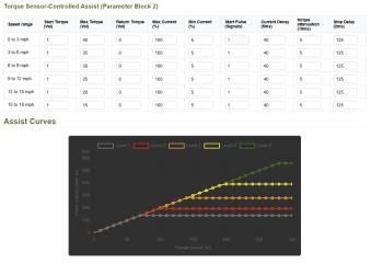

Hi, is there a way (what parameters to set) for changing the curves so I can obtain 600W putting only 100W of human power on my M820?
I just need to make the ramp more steep.
Yes and it worked like a charm right out of the box.
Thanks for your answer DPC18RI, but the link is broken... can you check it please?
so I made a dumb question... sorry... :confused:
I was misled by seeing parameters and graph together.
Thank you DPC18RI for pointing me to that. 🙏
