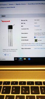

This is from a bafang G062 sensors have broken off the board which sensors do I need to buy, would that be SS41 ss41f or am I wrong any help please.
Not much difference. The only thing I could see is the SS41F is slightly more sensitive. It triggers at a lower flux. In a typical motor, the magnets are so strong and the gap between them is so small the timing difference this would cause would be extremely small.
In other words, the point at which the sensor turns on or off will be shifted by a tiny fraction of a degree. So tiny that it won't matter.
The one in the picture looks good.

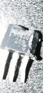

Please anyone know what HALL sensor I'd this is.
Please anyone know what this hall I'd is
Unfortunately no that's why I was hoping someone may recognize this sensor, but I have now installed the Honeywell SS41 sensors haven't tested yet but may e I will today.
