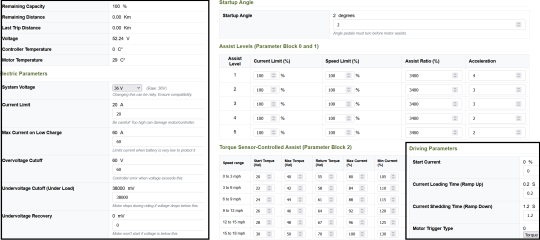

- "Pas Ramp End" is working incorrectly for me. I can get all 1000+ watts at the start of the movement, and as I increase my cadence to maximum, it feels like I'm hitting a wall. The stronger the assist mode, the stronger this feeling. In fact, the power drops to 300-400 watts, according to the display.
- PAS timeout – the power decreases significantly longer than indicated.
This parameter has no function yet. It is planned for a simple PAS mode with power levels. It is setable in the Canable tool, but it is not used for any calculation at the moment.
Hm, can you estimate the cadence where this happens? I had the same experience, but I thought, that this is the BEMF on a 36V battery. With the 52V battery this limit should be reached much later.... See #122

About the same as yours. My comfortable cadence is ~90 RPM. When accelerating at 140+ RPM, this problem becomes very serious. This effect definitely does not occur on the original firmware.
Hm, strange. Maybe Bafang uses field weakening. I guess, I have to do some tests with an 48V battery on the roller trainer.

I believe Innotrace M620 CAN motor controller has similar effect comparing with Innotrace X1 controller for some reason. On a 14S battery even if I lift current and power it pulls stronger than Innotrace X1 at lower cadence but not as strong at higher cadence even with higher current and wattage settings. You need higher voltage battery, maybe 16s or higher for wider cadence range support. I use 16S battery on my VESC M560 and VESC M600 controllers with the same firmware and it has very strong support at cadence even higher than I can spin the pedals.
The Bafang controller is physically limited to 60 volts. A 14S battery is the limit. Furthermore, the M510 officially supports 120 RPM, including at 36V. I wasn't aware of any RPM limitations while riding M510 and M560 motors with a 14S battery and the original firmware. Besides checking the cadence, I'll try to compare the firmware today.
Pretty sure they do have FOC. From a very crude ears only perspective when we changed the TSDZ2 engine to full FOC the electronics developed a certain sound to my ear. The Bafangs M510 & M600 have that same sound except the M820 which runs into a brick wall in cadence and power at anything over about 100 - 110rpm cadence.
