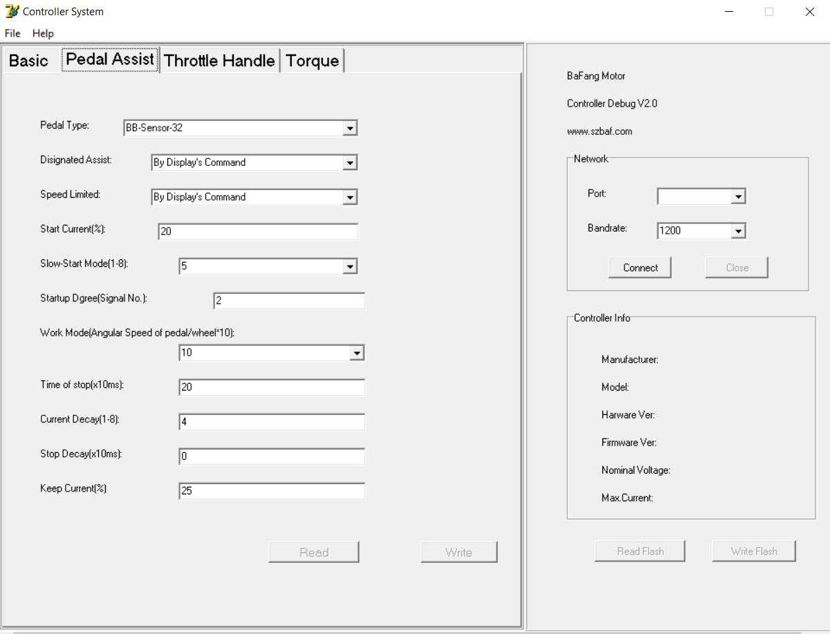

I have 3 BBS02 75O, I have mounted them on several bicycles and I am very happy but I wanted more power, so I acquired the Ultra and it was a great disappointment, the typical jerks that everyone complains about.
For Ultra to work exactly like a BBsX:
The changes are marked with red
What is not marked is unchanged
In the Torque tab, the first column is configured so that when starting from the state of rest you have to exert force so as not to force the battery.
Note 1, this setting is in sport mode.
Note 2, the eco mode does not change.
Note 3, sorry for my English, I'm Argentine, from Rosario.
Thank you
Greetings

After the first 30km's of driving with the AM1000, I have tried some settings from the Frey AM1000 topic & started to tweak those.
Now I really think i'm close to the perfect MTB/Trail settings for the ultra max.
You need to work a little (if you set the display to 9 power levels, its great) to get the power out of the drive, but thats how i like it the most.
Will post the other tab's later.

They make the power much more linear, but the higher the PAS setting the more risk at jerking because of the added power the drive has of course.
Other tabs:
I find these settings the perfect MTB/Trail settings, mostly drive on PAs setting 3 or 4 when on trails.
Higher settings are for road use/commuting.

Hi, Egg rider is a very smart tool but unfortunately, as far as I know, does not have the "Torque" page settings that seems to be very useful for max drive

In the comments here robocam aka "Just Enjoying Life" (replying to a comment about the torque tab) indicates the EggRider can program those settings now too. Not sure if he was replying to the generic ability to program or to program torque. It's clearly missing in eggrider's youtube video from a year ago:
https://www.youtube.com/watch?v=dE2Vmq5bMo4
Karl mentions needing to run a specific exe (presumably newer version of the programming software) to get the torque programming tab:
https://electricbike-blog.com/2017/11/23/i-void-warranties-hacking-the-bafang-ultra-max-mid-drive-ebike-drive/
In order to access the program with the torque setting, you need to run the executable Controllerst_torque.exe inside the zip file.
teirobc said:
Could anyone support me with explanation about Torque parameters functions in the table
See robocam's video. He explains some of the parameters. Spd0 would be the settings for stand still, Spd20 would be 20% of maximum speed, and so on. Start KG would be minimum force required to initiate torque sensing (Min Cur%) and Full KG would be the force at which Max Cur% is blended in. If you make both Min and Max Cur 100% as pisu did above I think you would have no blended torque sensing but more of an on/off.
Karl also explains the parameters here: https://electricbike-blog.com/2017/11/23/i-void-warranties-hacking-the-bafang-ultra-max-mid-drive-ebike-drive/

I would test changing the spd0 and see if it applies to both sport/eco. My guess is it will apply to both, with eco being some % transformation of sport. If not then I would guess sport is whatever torque settings you program on the controller, and eco is a separate torque setting that can't be programmed.
