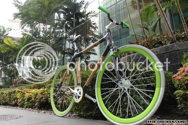

Holy crap that is impressive.. that battery box looks pretty sweet as well.. what a nice looking bike.
I did not realize bamboo was that strong. Love to see that thing in action.
This is possibly the coolest thing I have ever seen on ES. I don't even know where to start with how awesome it is... I love it.

That is so awesome. It looks rock and roll.
I can't believe I would ever use the term "stealth" in relation to a fluoro green bamboo bike, but that design of the battery and controller box down with the chainring etc.., is actually amazingly stealthy, and a great design. Hats off.
