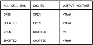

Stacking
View attachment cad_max_14920_bms_stacking.pdf
Let me first get off my chest that I haven't had a chance to test the stacking capability yet. Whew, feel better now. Modules are stacked by:
How many modules can be stacked?
I think there are at least three limiting factors involved:
Often, the LVC 5V current will be taken from the controller 5V throttle output (which is actually 4.4V if an Infineon controller is used). Your mileage may vary on this one. If we assume that we don't want the base voltage of the turned on charging mosfets to be less than 10V, then that would lead to a stack limit of 11 modules. The optos have isolation voltages in the multiple thousands of volts, so this appears not to be a factor here.
These are just some initial thoughts, my electrical knowledge is feeble enough that there are likely other factors. At some point I'll get round to building a small stack just to make sure the basic operation matches what I designed.

Stacking
- ANDing ALL_CELL_BAL outputs
- ANDing CHG_EN outputs
- ANDing CHG_CON
- Oring LVC SIG outputs
- ORing LVC 5V inputs
- LVC 5V current that is available.
- "Diode" voltage drop from ANDed CHG_EN outputs.
- Isolation voltage of LDA111 and LTV817 opto-isolators.
