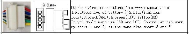

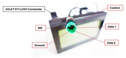

Now your bike display is powering up, so it's getting 36V, and you have checked it on the display connector? If it powers up, it sends battery power to the control pin to turn on the controller, See if you can find a way to measure that. One way to infer that is to check your throttle connector for voltage.
Another approach is to bypass the display, If this is a KT model, jumpering control to battery will do that. Here's how they do it with the flat display connector, They even ship that jumper plug with certain bare controllers,
It also works with the round connector, By the way, I have also done this with ebikeling controllers, a brainpower controller with the S866 display, and a Bafang BBS02 mid drive. They use the battery and control pins to start the controllers. In all theses cases, the controller has throttle and PAS,

From the LCD I have dismantled there's only one wire with 41.5v on it. It's a red wire inside the LCD so l hope they are using the same convention as in your picture. The pin marked 'control' in your picture is connected to a blue wire. Other wires are black green and yellow, so it looks like it matches your colour setup.
I've got the round connectors, so I'll try connecting red and blue inside my old LCD and see what happens. If nothing I'll then connect yellow to ground and try that.

Virtually all of these systems use the same 5-wire convention, B+ from controller, B+ back to controller on "ignition" when you turn on the display, TX, RX, and B- (ground). The protocols and data used on the TX/RX are quite varied, making intercompatibility rarer than it should be, but the rest are the same.
However, wire color varies widely, so don't go by color--go by the pad with the correct marking on the PCB, or by which pin on the connector they used (for those you can find a pinout for) etc. ;)

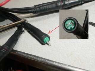

I found the problem, one of the pins in the connection between the system cable and controller had bent when I fitted the replacement system cable , so wasn't making a connection. Bent it back and my new LCD now works as it should.
I noticed when I was belling out the cable into the old broken control unit that there was a score down the inside of the connector, caused by the bent pin, which sent me to look at the connection between my new controller and new system cable - and there it was.

To complete the thread, for anyone else who comes across it while searching, the wire colours inside the LCD connect through to the circuit board in the controller marked as follows:
Red = g (this was the live wire at 41.5v)
Black = N
Green= TX
Blue = DM
Yellow = RX
Assuming DM=Control, the location of the pins in the Juliet connector also match those in the picture, so there's a very good chance if I'd tried the bypass based on docw009's pictures, it would have worked.
