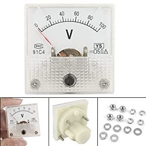

I prefer these $6-10 analog types, which you can build into the dashboard (though the needle is pretty thin):
50V:
http://www.amazon.com/Amico-0-50V-Voltage-Analog-Voltmeter/dp/B006Z95BJ0/ref=sr_1_2?s=automotive&ie=UTF8&qid=1338187816&sr=1-2
Concerning the 50V meter, I'm a bit concerned what would happen when the charger is plugged in.
It may surpass 50V, even 56V. Those 6 V may not pose an immediate danger, but they may in the long run.
Lucky they have a 100V version too, though on that one you'll see the needle most of the time in the 30-48% range of the spectrum.
100V:
http://www.amazon.com/Amico-0-100V-Voltage-Analog-Voltmeter/dp/B006Z959CY/ref=sr_1_4?s=automotive&ie=UTF8&qid=1338186442&sr=1-4
I prefer the digital one because meters with needle are sensitive with vibrations and unfortunately you will not be able to see its readings at night.Also i don't like typical volt meters because they will need battery replacement soon.I hate opening meters to replace there battery while they are mounted on something.

But just a voltmeter is an improvement on your led dispalys. With the led, how many volts are you sagging under load? Dunno. How low are you discharging the battery? dunno. You could look at your voltage with a voltmeter, then calibrate your led's to specific voltages and then you would know what voltage each led means.
