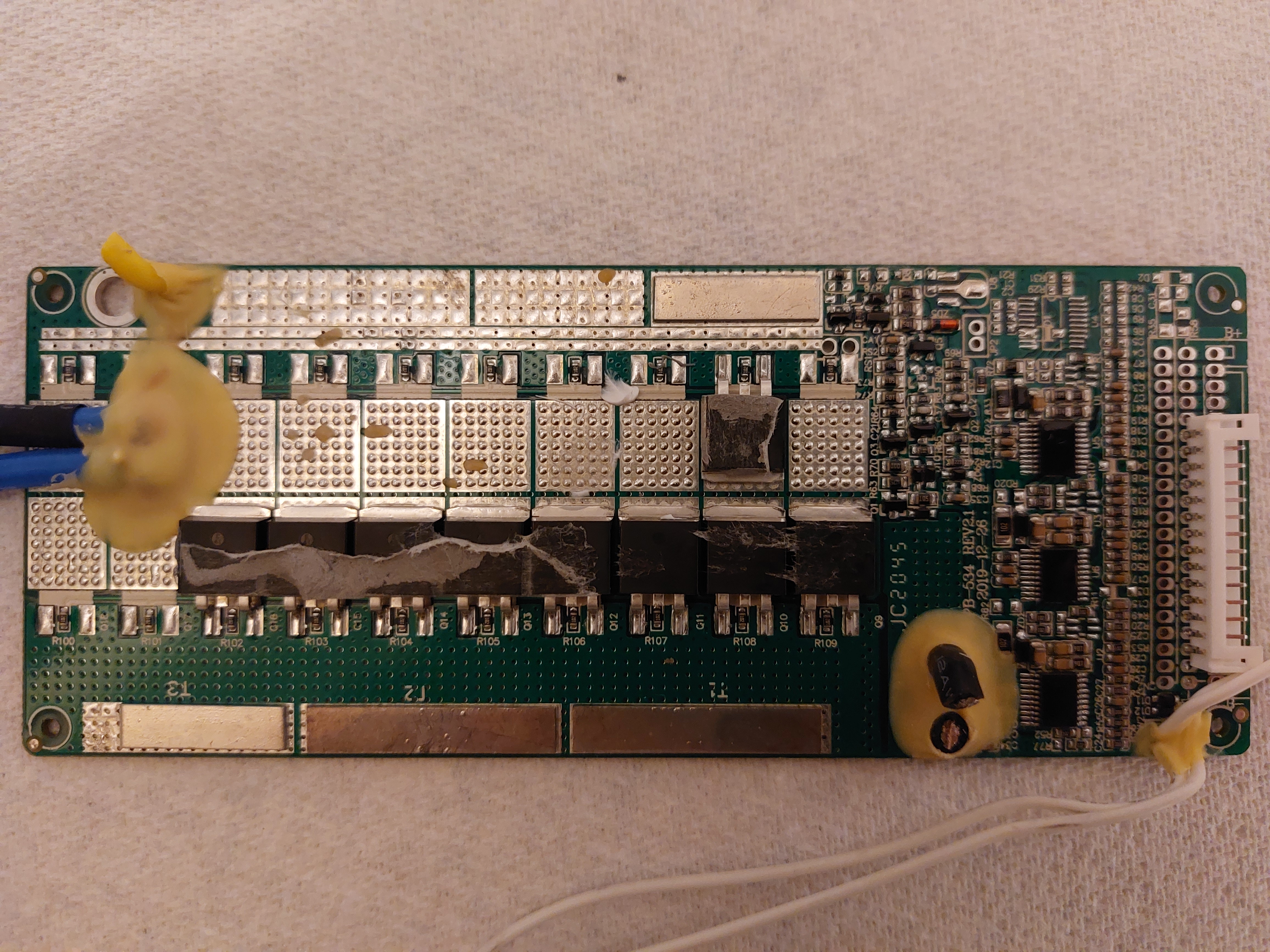

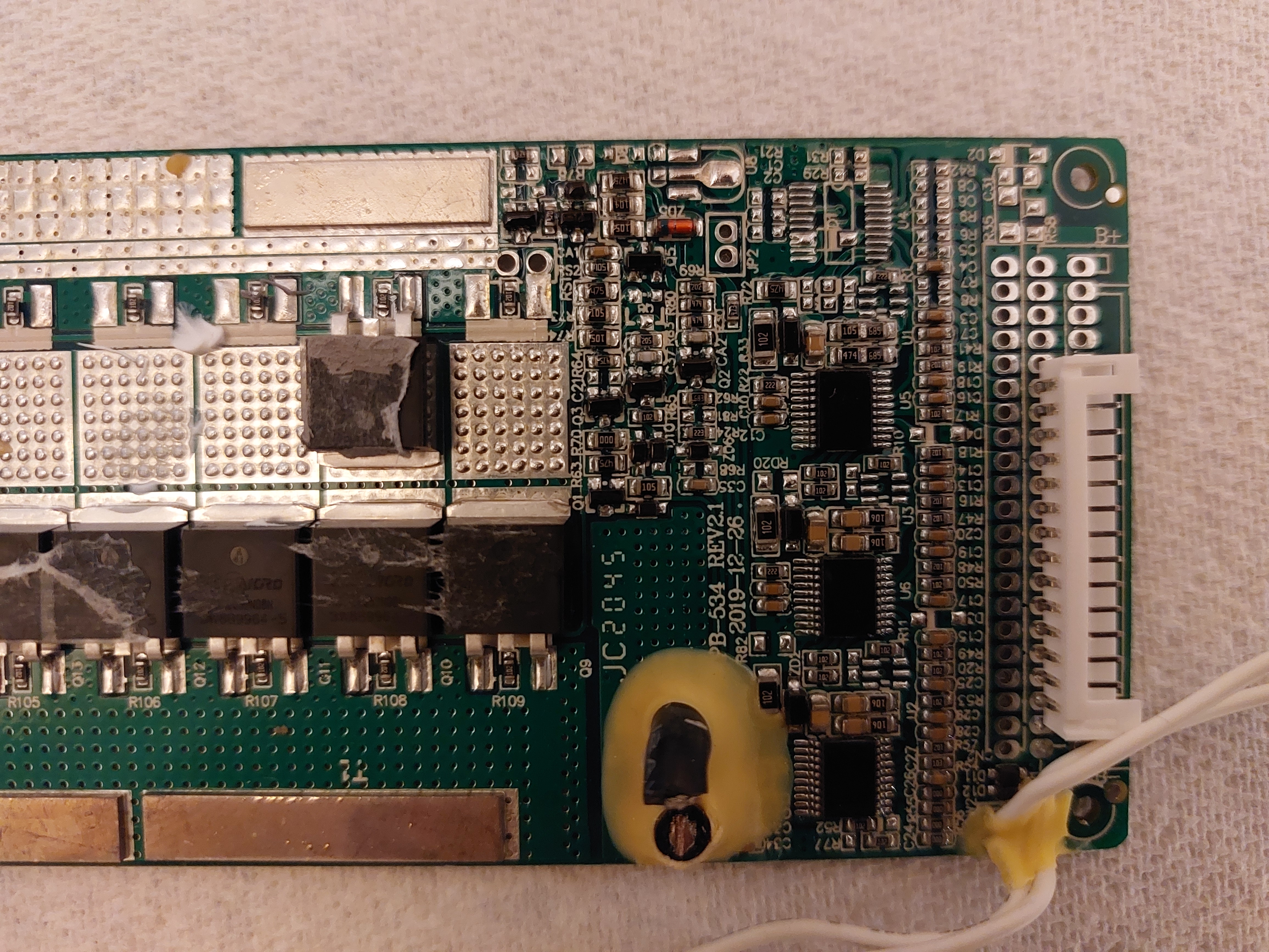

I kept the old BMS that I replaced in this battery, I replaced it with the same model so I took apart the one that is believed to be faulty and took pictures of it. I did try finding out if this BMS has balancing about a week ago, tried googling the part number but was not able to find data sheets or infomation on this BMS, I did find the manufacture's website and I found very similar BMSs to mine and they did have balancing built into it so I assumed that this one is likely to have balancing as well. Here's the picture of this BMS:
There's few components that look burned but they aren't, that section of the board is covered in clear layer of protective coat which is very reflective and it was hard to get a sharp picture.
There's no typical parts visible for the resistive shunt type balancers on this side of this BMS board.
What is on the back side of the BMS board?
It is possible that this is a capacitive charge-shuffling type of balancing board, but it is also possible that it is not, and only detects HVC/LVC and possibly overcurrent and shuts charge / discharge off as needed based on those. If it is the charge-shuffling type, it is unlikely to have the stuck-on balancer type of failure that drains cell groups.

I didn't take a picture of the back because there's isn't much going on there, it's mainly just traces. There's only seven 205 resistors by the balacing connector and five R003 resistors by battery negetive terminal, nothing that would indicate any sort of major circut.
Then it isn't likely a shunt-type balancing system, if it does balancing at all, so it is probably not a BMS failure causing the cell group voltage issue.
That leaves the cells themselves, or their interconnects.
If it's interconnects, you may see different voltages on cells within a parallel group; that's not possible if the interconnects are intact.
