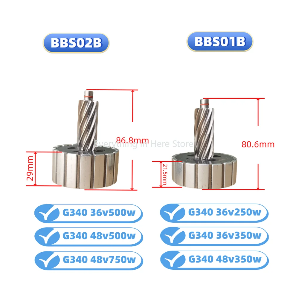

hello people,
i'm an owner of a 350w BBS01B, which i have connected to a 52v(14s) battery pack(fooling the 36v lock with a tvs diode as described here), with the controller set to 20a current(max that's allowed on the bbs01 controller)
it's been working fine for the last couple hundred kms, and regarding the heat, after pushing the motor for quite a bit i could still put my hand on the stator casing(measured aroung 50c with an IR thermometer) but im eager to get moar power.
the limiting factor right now is the controller, my first thought was to get a vesc(flipsky 75100 type deal), that would enable me to
1. push more than 20 amps baseline for more torque
2. push even more amps on top of that with field weakening and get higher top rpm
3. a bonus in the form of extreme flexibility of a vesc in terms of settings(as well as maybe fixing the throttle's 1 second input lag lol)
i, however, am worried about these things:
heat. even though im prepared to do all kinds of things to fight it - potting the coils with some thermal compound, increasing the contact area between coils and the outer casing(PC style thermal pads maybe??), adding additional cooling on the casing with heatsinks, i could even(attempt to) rewind the stator if the need be - but i assume there certainly is a limit where i just melt my windings no matter what - and what i want to know, what is the limit?
iron core saturation. i dont have a degree in electrical engineering(or any degree for that matter), so my knowledge in this aspect is very outside of my competence, but it's something that i've been warned to keep an eye on - apparently there's a threshold where adding more amps to a motor is no use since the iron core would be oversaturated with magnetic field. i have no idea how to estimate this number for my specific motor though... and it's an especially big concern for me, since bbs01 has a 30% thinner rotor than it's bbs02 older brother.
does my plan make any sense and is there a point in attempting this, or will i be disapointed and the 52v/20a is already pushing the physical limits of the motor? it would be quite a bummer if i threw away a hundred bucks on a vesc or a couple hundred on a vesc + cooked motor

basically, what i want to do, is to change out the default motor core with another aftermarket motor. after some research i decided to go with a large drone motor - 8318 rotor, 100kv, around 90*40 casing size. those are usually rated for around 50amps(although with the lack of a large prop blowing a tornado on them im not hoping for that much continuously).
i plan to mount it directly at the same spot where the default motor core goes, using a 3dprinted/cnc machined out of alu adapter plate, and a custom shaft for the motor - since those motors are outrunners im planning to reverse the shaft by routing it through the inside bearings to have everything on the same side. basically like this.
after taking apart the motor i started taking measurements and transferring them to a CAD model but quickly ran into a problem - these gears are an effing mystery.
there are 2 gears im working with - the nylon gear and the steel gear(that's machined as part of the rotor shaft on the default motor core, but i will have to get one machined for my custom shaft on the drone motor)
these measure as follows,
nylon - 32 teeth, 53.8mm outer diameter, left handed, 20 degree helical angle, 1.5 module
steel - 9 teeth, 18.0mm outer diameter, right handed, *the same*, *the same*
and these are the measurements of the "caves" for the gears. I have arrived 32.36mm center distance between the gears, and together with the discrepancy of the actual gear size and projected gear size based on the parameters(the steel gear is almost 0,7mm smaller than a 9 tooth 20deg angle 1.5 module is supposed to be) - I suspect the gears have profile shift(or I just suck with calipers). going to look into it more tonight.
if anyone haa any comments on the idea or more precise measurements of the gears that'd be greatly appreciated
another thing i think I should adress is the gearing. even though I bought the lowest kv motor that's commonly produced in this formfactor(getting one with custom winding is 120€+ so I sticked with the used ones, i got mine for under 40€) it's still almost 2x the rpm/v of the default. even with the smallest chainring available for bafangs(32t), I will end up with pretty awkward gearing(no "tank" gears and an unrealistic top speed) and 237rpm on the cranks(I will be running a 14s battery). which I don't really mind since with such a motor pedaling is basically pointless anyways.
