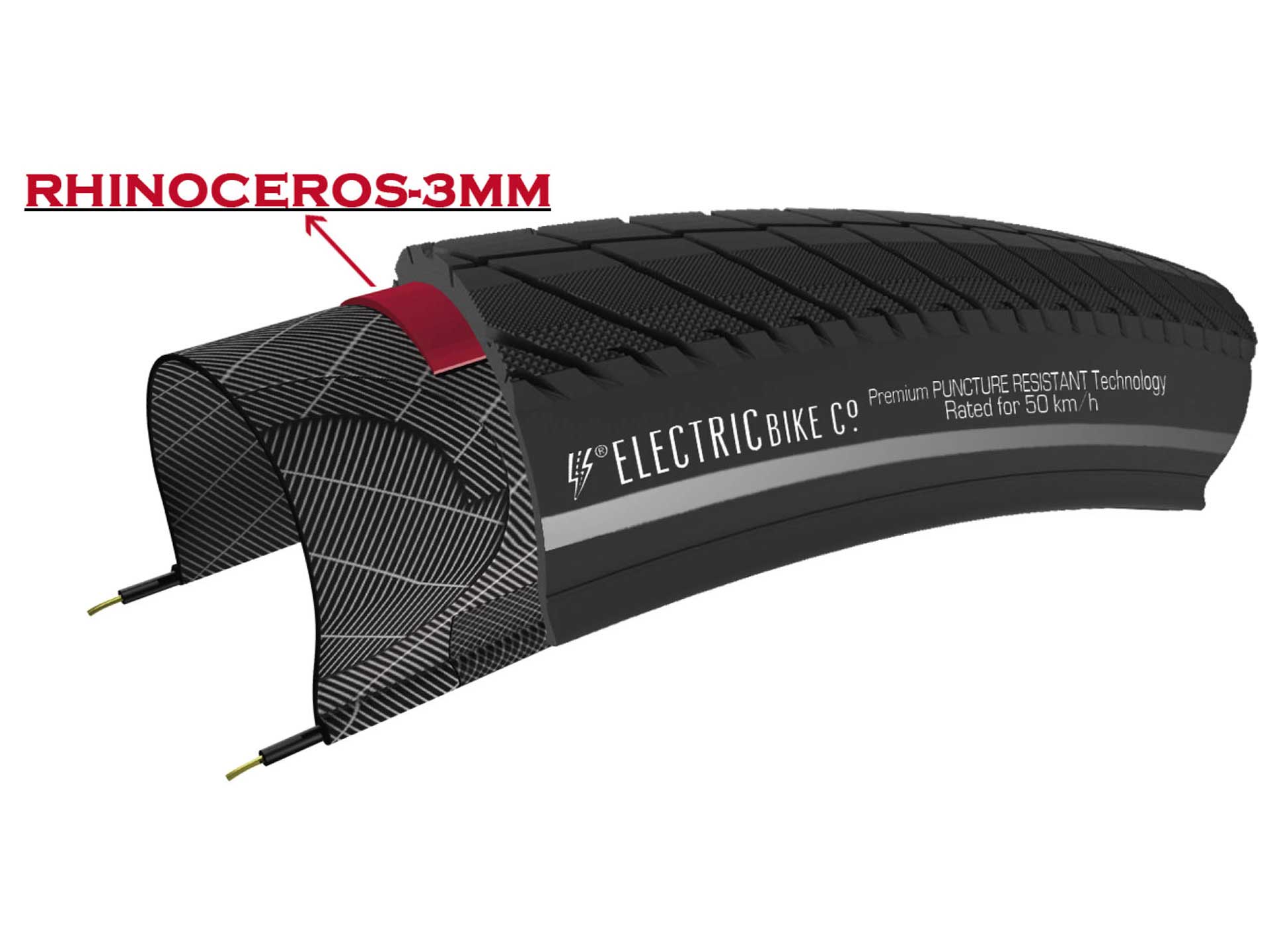

EBC sells an EBC-branded tire made by Gumonder (GMD) of Taiwan, which they call "Rhino". It's 26x3.0" with double layer casing and 3mm breaker belt. That one is a very good choice for a heavy and powerful e-bike, if it fits in the frame/fork.
Hookworm is preferable when ride quality and handling are the most important factors.
