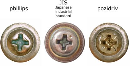

IIRC, the screws aren't Philips, but either JIS or pozidrive. all 3 of those heads look nearly identical, except that the driver for any one of them quickly strips the other 2. They are also held in with a thread locker of some kind. it's been >5 years since I had a Clyte apart. Check the heads, get the right bit, then use an impact driver and a hammer to shock them loose.
