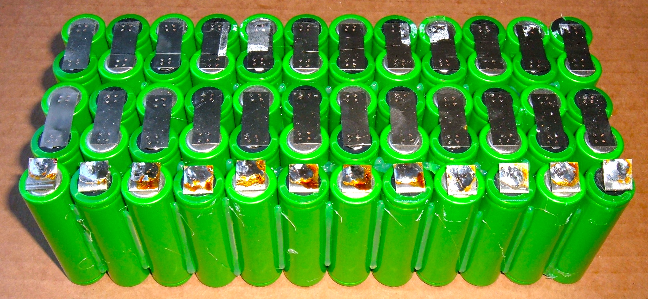

Hi guys. I've recently been gifted this ~ 2012 BionX ebike but I need to replace its BionX battery and I'm having problems finding a place that sells them or ships them to Toronto, preferably the 48V or higher capacity batteries. The batteries I found on Amazon.ca all seem to have a different type of discharge cable connection (HT60) to motor (350W). Does anybody still sell BionX replacement batteries or converter of some kind for the HT60 connection? I've attached some pics of my current battery port & its connections from motor.

BionX was a proprietary system that went out of business in 2018. Nobody currently makes replacement batteries for them. Nethers Batteries in Muskegon Michigan rebuilt them with good cells but is also no longer in business.
You can do some searching and find some threads of DIY rebuilding of the early 36V BionX batteries.
The main problem is that the rest of the system requires handshaking signals from the additional pins on that D-sub connector you show on your first photo.

No, I'm not telling you that. I'm answering your question asking if replacement batteries are available. No. Depending on the model, it may be DIY rebuildable. See the Syonyk blog, among others:
Unless of course I use it as a regular bike which I'm not really interested in. What a waste.
The hubmotor can be modified to work with a commonly available commodity controller and battery. Informative video on Grin's website:
