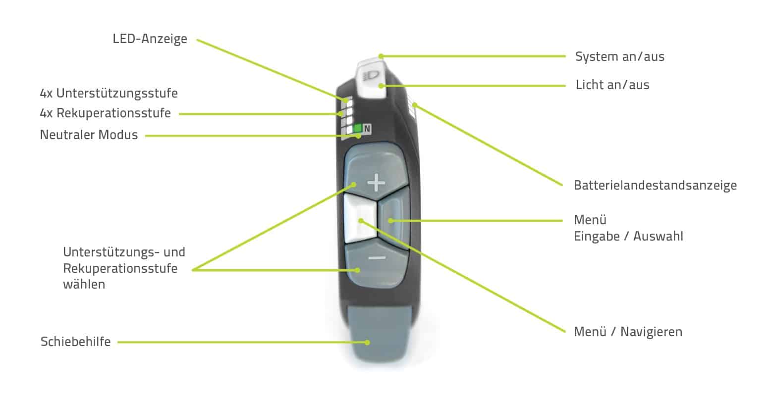

For me the most interesting aspect would be to use the BionX DS3 Display and the BionX RC3 controllers.
BionX is bancrupt, but maybe there is a Company (in China?) that made those and can do it again?
The RC3 offers 6 Buttons for on/off, light, "left" and "right" (as on the CA3 itself) and "up" and "down" like on the Digi AUX Buttons plus an throttle and some led for power assist and battery Status. All the size of a simple Chinese 2 button Setup.
The Display can Show plenty of info in various colors. You need only one CAN bus connector (sadly the Hirose HR30 is not avilable anymore, it is a good connector imho) and the setup is small, nice and perfectly waterproof.
Those are "stupid" devices, they only Need commands from CAN bus, but this is far beyond my own ablities.
The thing I hate most with the "open source" standard setups is the abundance of cables and (oftne not waterproof) connectors and the clumsy lucking Input devices. Here BionX has been 30 years ahaed. The bad side is the price and if something fails it is difficult bis impossible to repair. But for going on a trip I would just take some sparte parts. DS3 weights 42g, RC3 weights 41g.
But most likey this is only a very small niche and so it will never happen. For the BionX Motors a external per Controller would be intersting. With the newer BionX Firmware all of the "intelligence" sits into the BionX Motor and both the battery and the RC3/DS3 are just stupid CAN devices. It should be possible to make a CAN Controller that can use the BionX Controller with standard eqipment. There should be x-thousands of those PL and SL Motors avaiable and usally you can buy them used for something like 200 Euro incl. a wheel. 200€ for a used "1000W" motor with a nice street legal labeling incl. "torque" sensor and incl. a 48V 30A Controller is not expensive imho.
