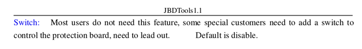

just for clearity: i got one of these here:
https://www.aliexpress.com/item/15S-60A-active-bms-2017-new-Li-ion-smart-bms-pcm-with-android-Bluetooth-app-UART/32833964039.html
15s 60a max for li-ion. interestingly, when i connected it to the bt module and installed the apk for the android phone, which worked flawlessly, i got pre-set voltages for some other lithium chemestry, but not li.ion.
i tried to raise max voltage cutoff to 4.250V, but couldn't set it above 3.9V.
i then tried the pc software, which worked fine as well. of course it has this awful chinese look, but who really cares as long as it works and got latin characters. with the pc software i was able to set it to correct values w/o problems. after that i was able to set the same high voltages through the android app as well.
these are the values right now:
.) anyone got an idea how to make it actively balance at any voltage i set - just to test. i set balance to 3.3v and set "active balance" but i can't see anything happen.
.) any idea how to use the "switch" feature?
.) led features are completely useless i guess, as i can't see any leds on the pcb. correct?
