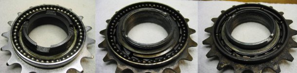

A look inside three common single-cog freewheels. These are large images so you can get a good look.
Two of these freewheels might be used on an ebike, for a primary drive at the hub, stacked at the hub for dual drive, or as part of a BB setup. Can you guess which one wouldn't?

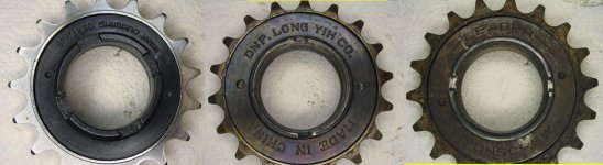

Cheap = Shimano mx30 (~$15)
Cheaper=Long Yih (~$5)
Cheapest = Leader (~$2)
The Shimano was removed without using heat, the other two needed persuasion using "the blue wrench"; hence the discoloration and cooked grease.
Inside, the Leader has wire substituted for many bearings.

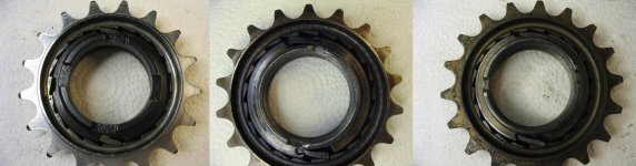

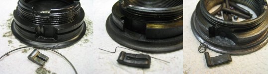

The pawls in the Shimano move silently and precisely, the Long clicks, the Leader clicks loudly and the pawls wobble.
The Shimano springs are thick and surround the hub. The Long Yih springs are thin and fit in a groove in the hub. The Leader springs are smashed and barely get the pawls engaged.

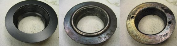

The Shimano back is well machined and flush. The Long reveals that the hub is made from two pieces pressed together. The Leader shows the holes for the pawls' pins.
The Shimano pawls both engage at the same time due to an even number of CPs (contact points = 20). The other two have 21 CPs, so only one pawl is engaged at a time. All of the force of a cyclist or motor is bearing on one pawl.

The Leader is very loud and has significant play or slop in its rotation. The Long Yih has less. The Shimano has no sound and no slop.
