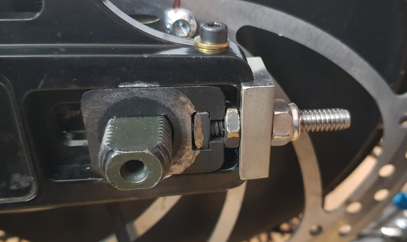

If you are power addicted or simply a power junkie...never buy a frame without clamping dropouts. :roll:
its "normal" that sometimes after replacing tires that your axle nuts come lose 2 or 3 times.
after some nice days in austria riding where other ppl skiing i noticed some weird sounds...creeking and squeeking on accelerating and ebraking.
after checking all movable parts, including suspension brackets etc it took me some time to find out Axle nuts were a bit lose.
my bad...didnt had a frame for years without clamping dropouts.

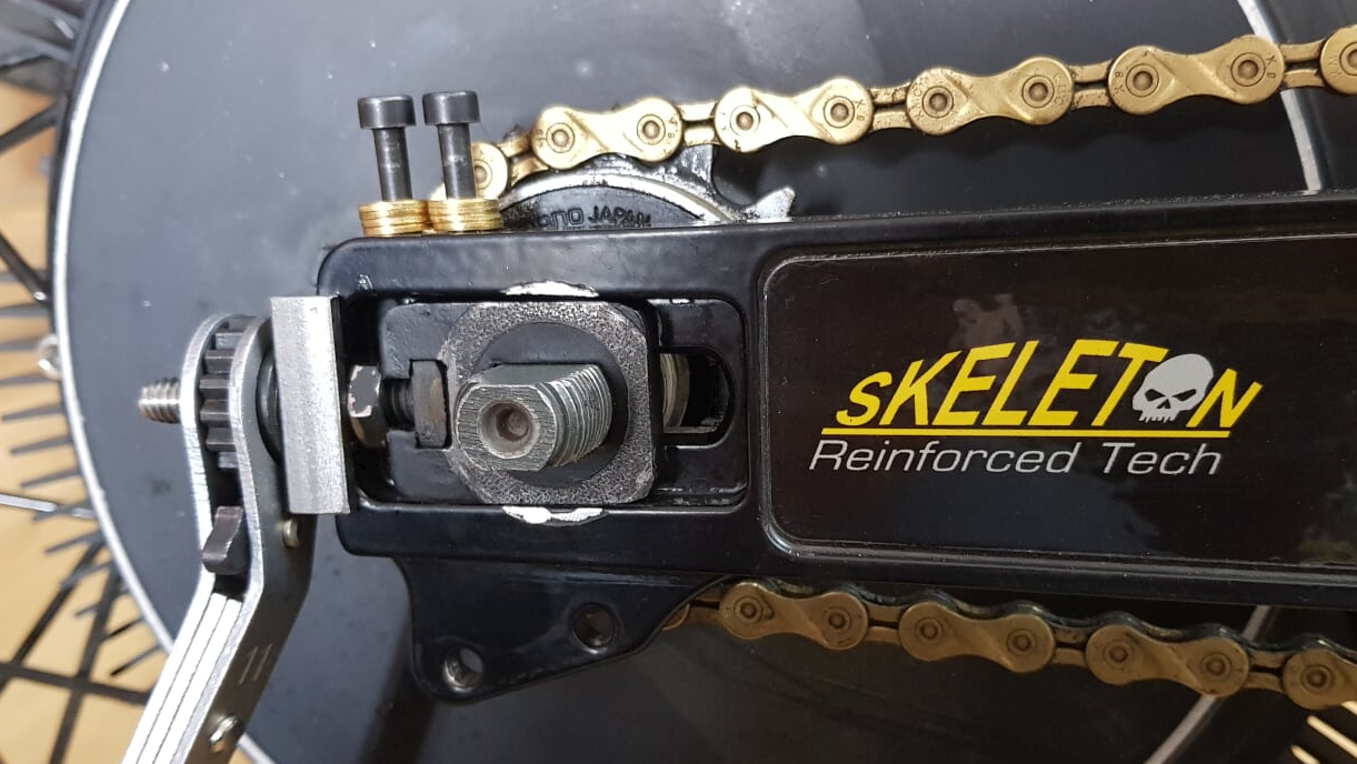

....tighten then up going out for a ride....a Single Full Power run 0-80mph, ebraking and sound was again there.
rolling home thinking about why they are lose again.

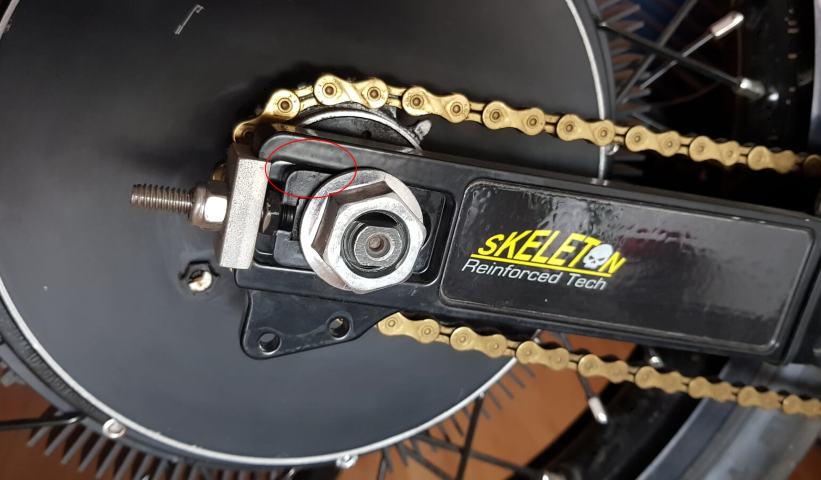

....at home checking the nuts..but they were tighten rock solid. "this time"...it was something other:
yep...on the right side dropouts are "slightly" bend.
What should i do now?....emailed NYX for ideas. But abit as expected. no Answer till now.
as it is aluminium its not a good idea to (over)bend it back to "normal".
i tried a really small and short pipe wrench and was surprised how easy i "could" bend this 6x12mm end of dropouts.
i only need a single hand to bend it...wow...what a fantastic piece of art.
this complete swingarm is not for that power levels. it flexes side to side like a cows tail with very less effort. i could make a video if someone is interessted.
if you hammer the throttle from a dead stop. be carefull with 10kw+ Power levels.
i like drag racing. so its probably my mistake doing full power runs from a dead stop with this frame.
but to be honest i wasnt afraid of dropout failures because doc bass pushed always the limits and still running nyx bikes.
Luke also build an nyx with a bigger 273 motor.

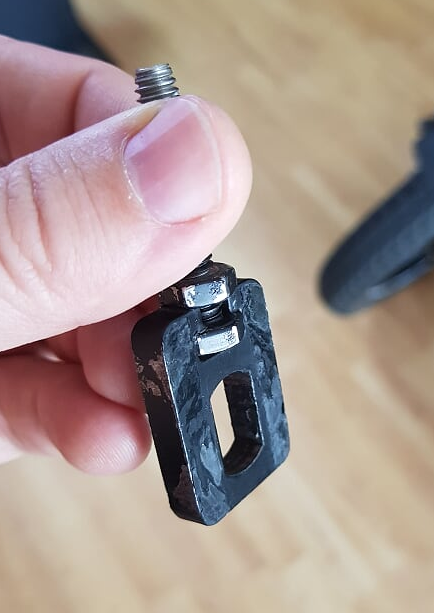

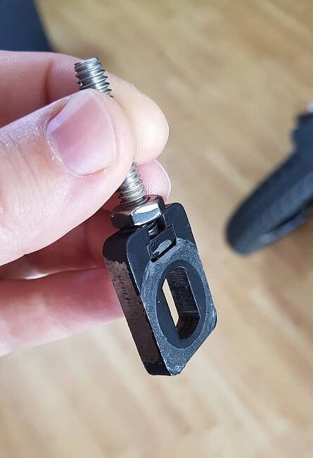

anyway. For others who wants to protect the possibilty of a bend dropout....heres my solution.
That's a nice bit of bodging. What size bolts did you use?
I have a new issue. I replaced the snapped suspension bolts today, but now there is a huge amount of play on the swingarm shoulders due to worn POM bushings. This is my second set of bushings. I just looked up my old emails to NYX and i had replaced the bushings exactly one year ago. So this will soon to be my 3rd set. I only use my bike for off road use which is once a week at most. I dont mind paying for new bushings at $15 dollars each but paying $45 for postage takes the p-ss! They only weigh a couple of grams :cry:
M4 bolts. No more room for bigger bolts.
But when you tighten then even M2 should do the job. Its so easy to bend this part.
took another run now. looks and "sounds" good for now. Feels "stiff" again. Time will show.
