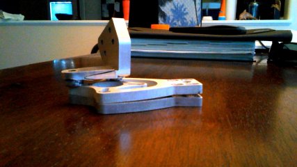

Pictures would be nice. I'd like to see how you created your caliber motor mount. Are you saying that the mount is slipping and isn't staying on? The holey mount kept coming undone and had a few bolts snap when using locktite. One of the mounts also snapped as well. This is mainly the reason why I went with my own welded mount solution although I would prefer a bolted motor mount if it worked well and didn't have any issues.
Now, that I'm thinking about it. I would think maybe 3-4 set screws on the other sides of the motor mount would help. Preferably, not an actual set screw but an actual screw. Depending on the size of the caliber bracket perhaps M4, M5 screws to hold the bracket onto the trucks.
Can I just steer this back to the posts topic.. ADS..
I just need to point out that out of maybe over 150 kits , no other customer has complained of the holey mount breaking ..
With regards the Caliber mount and the motor brackets, they are machined from aircraft grade alloy to a much higher spec than is actually required for the task .
I have also had no complains from any customer about bending, breaking or movement of the bracket .
If anyone else has had a problem please don't hesitate to contact me .
Yes, they were high tensile screws they were 12.9. As I've mentioned before, they could be due to the terrain that I ride on. Most people, I would assume don't ride ridiculous terrain. I ended welding my ADS Holey to the trucks itself to stop worrying about the bracket falling off. Glad to know everyone else is enjoying them without any issues. We could only assume it's my issue then. :D
For those that wanted to see my old bracket I posted it over on the Aussie thread. Here's a link to avoid cross posting. Keep in mind this was a first draft I whipped up quickly as a prototype. I've learned from the Boosted blog and the experience of what's happened to this after 400+ kms. It's lasted pretty well for a half days work and a wood CNC :)
http://www.endless-sphere.com/forums/viewtopic.php?f=35&t=55046&p=820764#p820764

I've be plagued by a heavy road vibration problem with the Holey mounts. So far I've split one and done extensive modification the get the other to stay put. Success was achieved with a type of assembly compound, lock wire, a lock nut, and a longer bolt. It is rock solid, near if not equal to if it were welded on. What have you done to make the Caliber mount more vibration resistant, what is to prevent the mount from sliding along the axle under the stress of road vibration and the torque generated by a 63mm motor?
Secondly, I want a replacement Holey motor mount. I live in the US, can I get the mount via Bruno?
Regards,
Trevor
beetbocks said:
Sent: Wed Sep 25, 2013 8:43 am
by beetbocks
Hi Trevor
Well I'm at a loss really , as you are the only customer to have this problem and I have myself done many miles on my dual 63mn on very rough British road and I've had no problem and tbh I don't use loctite as I'm always changing setups for testing. I just check and tighten regular .
The caliber mount is locked in place with stainless m6 bolt .its not going any where .
No I'm afraid you cannot get mounts from Bruno .
I hope to be able to sell to the US. Soon .
Regards
Richard
Yes I recall that ,I also recall it was a vibration problem where the bolts were coming lose not the bracket snapping in half like torqueboards..(which i still find hard to believe)
As i said in the pm- the caliber bracket is a lot more robust and is simpler to attach ( stopping problems with poor instalations) and I also pointed out that I will hopefully be able to sell to the US and send parts there very soon,unfortuantly the insurance companies are taking far longer than I ever expected to come back with a reasonable qoute -to allow me to trade in the US.(until then -they have stated I cannot send any parts the US-even spares) so for that i apologise
I still stand by my statement that I will send a replacement bracket out as soon as I can trade to the US.
I must take this opportunity to point out that these kits were really intended for use on tarmac or paved roads and not rough terrain. Whilst I have also tried to make the kits as easy to fit as possible -They do still need some mechanical knowledge and if they are not fitted correctly they will simply not work perfectly and cause stress on parts.This is why I offer as much advice as I can to customers and provide videos etc to help whenever I can but obviously I cannot be there to fit them for you so they may always be some problems.
That is why i will replace any broken part of my kits ( as long as it wasnt from abusive riding) and offer as much help and advice to resolve the problem I can ,i really cannot say any fairer than that, but i am open to any suggestions from members..
Alien motor mounts are great and work good WITHOUT the added stress of rough terrain. I do like the Alien motor mounts but for my own application they are not durable enough. I cannot stress this enough.
On tarmac, flatground, paved roads there should not be an issue ever with the motor mounts cracking, snapping and/or bending. All issues, I have had are all due to rough terrain. Bolts were also loosening but that's from sidewalks that are bumpy and rough terrain and not flat pavement completely. Flat pavement the motor mounts hold up perfectly and bolts don't loosen.
The Alien Drive Hubs on the other hand are perfect and work great, very durable. I have had no issues with them and would recommend them for others who are looking for a simple kit. My only downside would be they are a very tight fit and don't think I can ever take the drive wheel out of the wheel unless with extreme force. :mrgreen:

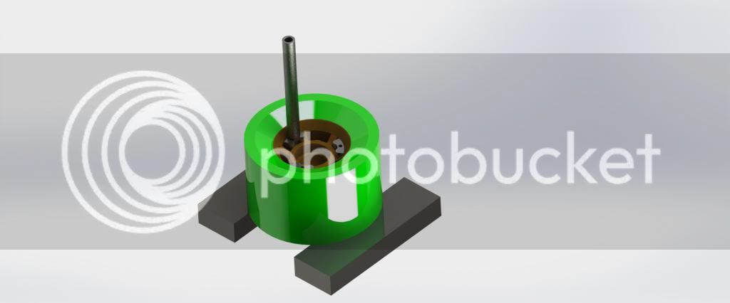

They have to be a tight fit so they are concentric but a good tip to remove them is to simply use a dowel or 4 or 5 mm bolt (it must have a flat end) - turn the wheel over and rest on an open vise so the vice jaws sits outside the hub drive on the urethane.. then just tap the hub out working your way around the three legs a bit at a time - I actually use an old hub that I've ground down so its a loose fit in the wheel and I tap it through from the other side in one go-
