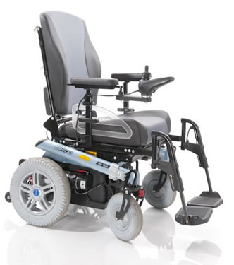

hello,
up to today I think the best wheelchair for legs disabilities is the zoomcamp
http://www.youtube.com/watch?v=4DD8gNhg9hM
the only problem is that you need fully functional arms to control it so can be useful only if you are young and witout legs.
For older people it can be hard to control and most of the time a differential drive with 2 caster wheel in the back is the best option like the Ottobock B600/B500
one of the biggest improvment is the switcing from the old rear drive configuration
to the new front wheel drive configuration ( the B600 still be compatible with both configuration but for the future front drive is much better)
FWIW, out of the styles I have ridden, I find the ones with larger center-drive wheels and casters at the four corners easiest to maneuver, if I have to use a joystick or other non-handlebar method to control it, plus it can turn as a pivot around it's own center point, so it works very well indoors or if I have ot turn it around on a sidewalk, narrow path, etc.
