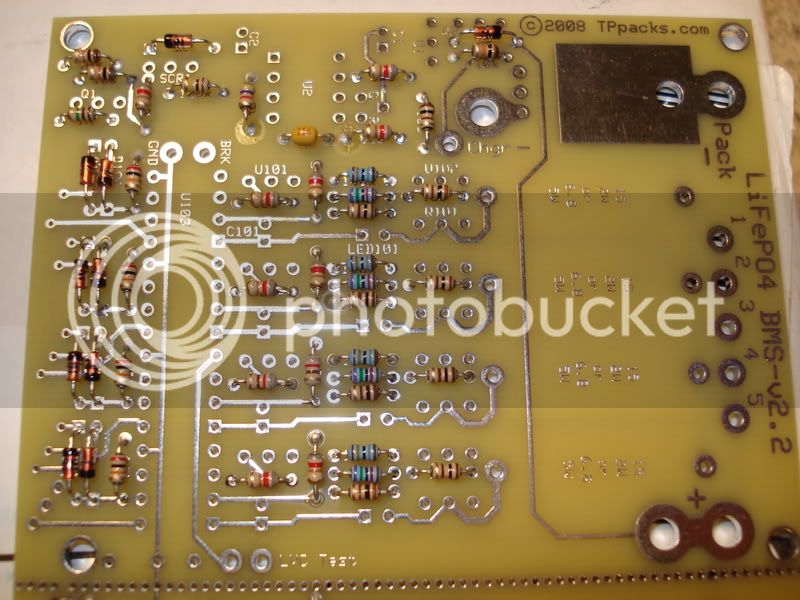

Anyway, here's some more progress I made today. I finally got all the parts yestruday, so nothing is holding me up to complete this project.
I have all small resistors, fairchild diodes, and a tiny C4 axial capacitor installed. If y'all see anything I screwed up, please chime in.

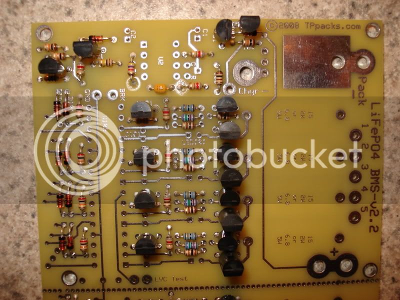

I now have all the transistors, and voltage detectors installed.
OK,
I have three components I need to figure out how they get situated on the board.
1. The three pronged Bi-colored LED. One point is G, the other R. Which is which?
2. The 16-channel LED's. I just want to make sure they go the right way. On whole is square, the other round.
3. The C4 capacitor. It says axial, so I assume they are bi-directional, and that it doesn't matter which way they are installed?

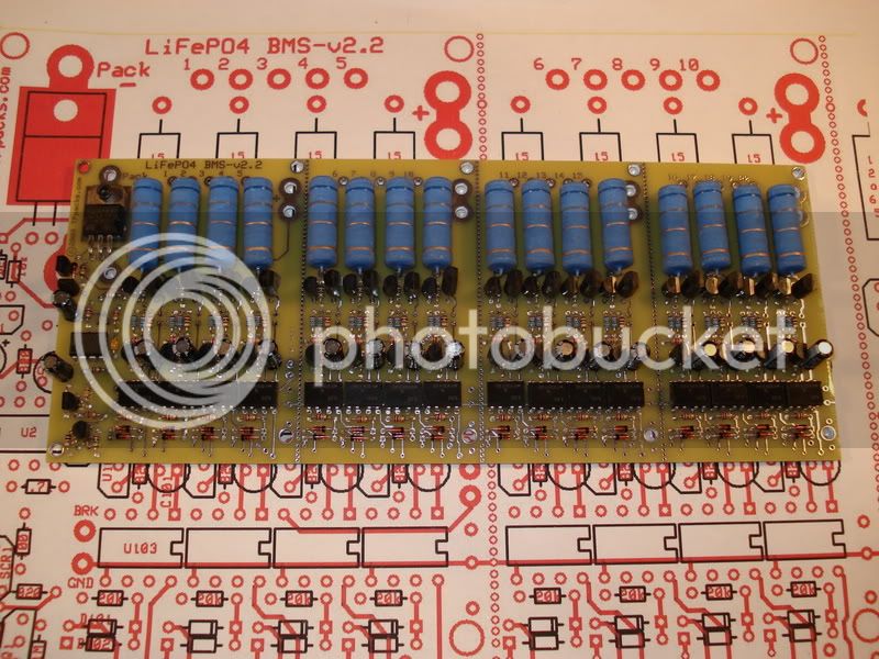

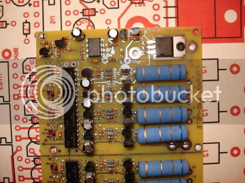

Just got done with everything else, except for the LED's. I'll have to decipher everything written above, and then finish this baby up, with a 17pin connector, and battery leads.
Looking good!
Be sure to hold it up to a light and examine the bottom side for accidental bridges, especially around the diodes.
