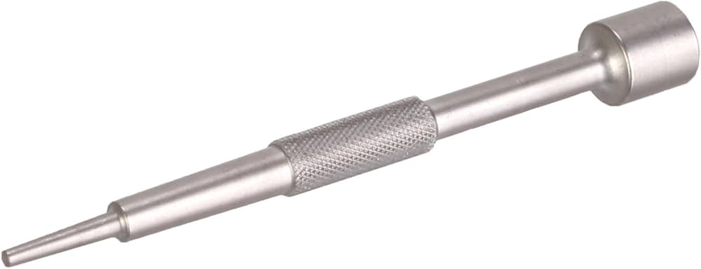

Here's what I use for initial assembly, in either store-bought or homemade version, a Mulfinger nipple loading tool. If I were building only a few wheels ever, I'd still want to make a homemade one out of some 2.5mm to 1/8" rod by grinding a shallow taper and then shortening it to the correct depth:

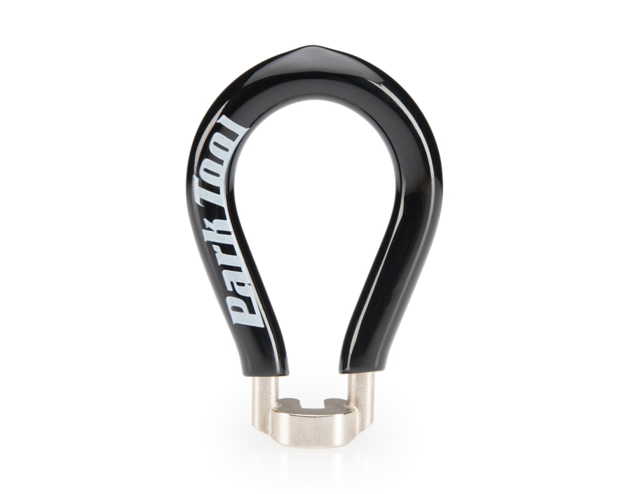

Then to take the spokes up to modest tension, I use a Park Tool SW-0 key, which is the most handy shape and size I've come across yet. This is the spoke wrench I'd use if I only had one:
