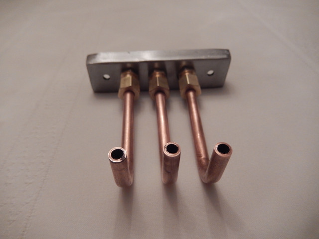

Mental block - fuel block
Finally settled on how I will transition from the carb copper tubing to the fuel block.
I'm using scrap copper tubing for this mock-up.
Cut the block from a 1x1 square tube. Cut it long way to 1/2 " thickness
Welded ends on it and drilled appropriate holes for mounting the fittings and mounting screws.
Finish grinding/sanding yet to be done.

The second fuel block was completed this morning. And the remaining copper tubing was cut and bent to exacting specifications.
Here the first of two blocks are connected. Too tight to secure to the firewall just yet.
Bought some clear tubing to replace the red tube that I canceled but will be receiving anyway. 😕
I actually like the clear better at this time, because it blends in with the tubing, and doesn't become the focal point. We'll have to see what the red tube looks like, if and when it does arrive.
Still need to install the hose clamps.. Hopefully, the clear tubing will straighten out in time.
