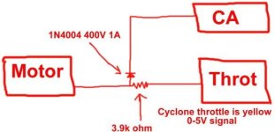

i have a cyclone 500W 24v kit on my bike.
i also have a CA-SA hooked up. i am attempting to hook up the current limiting feature on the CA.
according to the instruction manual (and an email i got from the store) with the use of a 3-5k resister and a diode,
i can use the current limiting features.
the problem im having is that i wired the resistor and diode in the correct places and orientation (for the diode),
but i now have zero throttle. there is a 0 - 5 v signal above the resistor (throttle side), but nothing below it (motor side).
with the resister removed (and diode left in place) i have throttle again.
i have not connected the diode line to the CA yet.
as the instructions say to use a 3k-5k resister, i went for the middle ground, and got a 3.9k one.
the diode (which does not appear to be a part of this problem) is a 1N4004 400V 1A diode.
can anyone offer info and advice on what's happening here ?
i really want to use the current limiting feature of the CA as the cyclone units do not seem to have a limit built in.
and i do not want to cook the controller. i have already seen peaks of 44A on what is supposed to be a 35A controller !
can anyone help ?
above is how i hooked it up.
Jason.
Hi Jason, I can help you with this.
You need to use a lower value resistor.
I had the same problem with my 650W Cyclone and CA-SA meter. Using the hookup as described on the CA webpage, using a 3.9K resistor resulted in almost no throttle response. I contacted Justin about this, and he suggested using a lower value resistor. He also indicated that it sounds like the Cyclone system uses a much lower impedance to the throttle input at the controller end than theCrystalyte units. You can eliminate the resistor entirely IF you have a CycelAnalyst board that says DB2 Rev7b on it. These have an internal current limit of 5mA to prevent the op-amp buffer from being damaged if it has to sink too much current from the Throttle-Override line. If not, then you could try going down to about a 1K resistor
I tried several lower ohm resistors and found with a 1K ohm resistor that it all works fine now.

With the 3.9k in place, the motor would not even turn. i put two of the 3.9k's in parallel (2k) and got movement.
not much though. i was going to try 1k next, but based on your suggestion, i think it will work.
i will go out today and buy some 1k resistors. that way if the 1k still does not give full throttle, i can parallel two of them
to give me 500 ohms.
My CA-SA is only about 5 weeks old, so i should be able to use 500 ohm resistance ?

i tried the 1k, i had full throttle, but nothing until the last few mm of travel on the throttle.
i tried the 500ohm and it got better, so i ended up putting two 500ohm resisters in parallel
for 250 ohms, and it's not perfect but i can live with it now (i think).
ill go for a ride this afternoon and try it out. if all else fails, ill just remove the resistors and try that.
Jason

edit...Update:
i just tried the limiting features with a 1k resistor in place.
it now seems as if the limits are working, but the down side is that i now only have half the throttle travel as i did before....
i have to move the throttle about half way before i get anything from the motor.
at full twist, i am still getting full throttle though.
so it seems i have limited the resolution of the throttle, but if the limits now work, ill live with it.
Jason.
