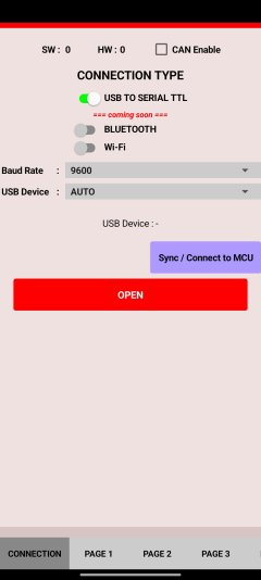

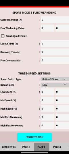

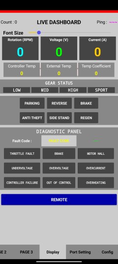

Hi everyone,,
I release
Android App Support for VOTOL Tuning
(Now Available on Play Store!) 🛠️⚡
SAMUDRA EV LINK is an alternative third-party utility tool designed for mechanics and electric vehicle enthusiasts to tune and configure Votol controllers effortlessly via a USB OTG cable connection—directly from your Android phone! No more carrying heavy laptops around.
Main App Features:
📊 Easy Parameter Tuning: Adjust current limits, speed, and the power curve over a USB connection.
💾 Local Configuration Management: Save your parameter setups safely in your phone's internal storage.
🔄 Export & Import Files: Generated files are 100% compatible with official desktop tuning applications (PC/Laptop).
☁️ Cloud Sharing: Seamlessly share or back up your best tuning profiles to the cloud network.
🔑 Instant & Secure Login: Sign in quickly using your Google account with just a single click.
🖥️ Keep Screen Awake: Your phone screen will stay turned on as long as the USB Serial status is OPEN/CONNECTED.
⚠️ IMPORTANT NOTE: The core tuning and USB connectivity features require your physical Votol controller hardware and a compatible USB OTG cable. Setting fields will remain locked until the device is connected.
