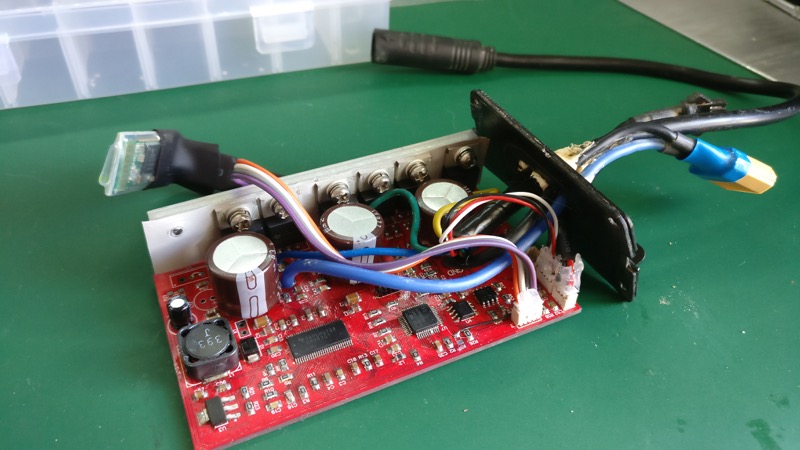

I just found a cheap chinese controller (that BMSBAttery sells) and that uses the famous STM32F103*, does FOC and have LCD/UART/Bluetooth -- please see here my notes: https://opensourceebikefirmware.bitbucket.io/Controllers--Lishui_motor_controllers.html
This controller is not so popular as the Kunteng controllers with STM8, maybe due to the smaller higher price... still, BMSBattery sells it as also some european online shops.
