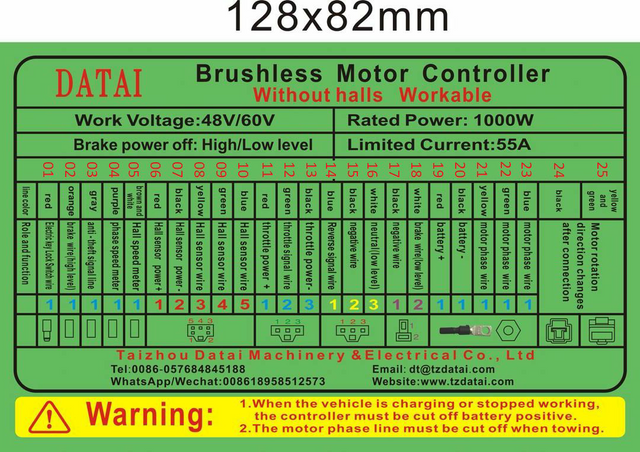

some friends of mine own a wedding event space. they bought an electric Tuk Tuk on Alibaba.com. came with no instructions or schematic. I am a motorcycle mechanic, they asked if i would come take a look at it and see if i could help. This is my first foray into EV technology, but I love a challenge and love learning about new technologies. This is like trying to put together a puzzle blindfolded. Every label or bit of potentially helpful information is in Chinese. I wired up the 5x12v batteries in series to give the 60v motor what it desires. At this point, the lights come on, the accessories function, but the motor doesn't respond to any throttle inputs.
The controller was a big of a mystery until yesterday. Most connections are made, but some wire ends are left disconnected. I was able to email the company in China and get an english version of the wire pinout. very helpful.
The first 5 wires listed are all disconnected. The hall sensor wires are patched to the motor. The throttle wires are patched to the throttle on the handlebars of the vehicle, but I haven't been able to meter any DCv between any of the leads. (This seems like a problem, but maybe it has to do with the next paragraph...) The fwd/reverse wires are patched to a thumbswitch on the handlebars, labeled in Chinese. The low level brake harness is disconnected. The wires going to the 60v battery source are patched, as are the 3 motor phases.
I have a feeling that the issue with my unresponsive motor has everything to do with the Red 01 connection, "Electric Key Lock Switch Wire", which is not connected to anything @ this point. I have seen from some reading in other threads here that this wire would want to see +5v to activate the controller. Currently, I can choose from 60DCv or 12DCv, on either side of the DC-DC converter. I don't have a 5v source. can i feed 12v to the Electric Key Lock Switch Wire?
Similarly, I have a question about the Low Level brake. Currently, the Vehicle only has a rather pathetic looking rear wheel drum braking system. There is a Brake Switch that activates the brake lights on the vehicle, And I think I could use that electrical functionality to patch into the Motor Controller's brake system. Perhaps, though, since the brake switch is a N/O 12v momentary switch, it would be best patched to the Orange wire High Level brake system? The brake lights will trigger the motor to disable itself.
Any clue what the last wires, "Motor rotation direction changes after connection" are for?

Usually you would put wire 01 (red) to your full pack voltage positive lead straight from the powertrain battery. You can have a switch to turn it on or off. It enables the go-logic in the controller.

If you want to know for sure what voltage that wire hooks up to, you can open the controller and trace where the wire goes.
If it's like most, that are powered off the batteryvoltage, they connect to the input of the LVPS (low voltage power supply) that generates the 12v / 5v to power the controller brain (MCU) and hall sensors, etc. The pad the wire goes to is usually near the big can capacitors at the battery input.
It's often called Keyswitch or Ignition. Sometimes electric lock.
*Some* of the things labeled electric lock are also called antitheft, and aren't the "power switch" but instead lock up the wheel by actively powering it against movement.
so i applied 60v to the 01 Red wire, and it enabled the motor to spin, using the throttle. I had an inquiry open with the company via email in order to get an english copy of that wire labeling, and the nice chinese human on the other side of the line was kind enough to also confirm that it needed 60v.

Looking at the signal names in the wiring chart, there are three signals related to disabling the controller without powering it off. Two are the high and low level brakes, and the third is "neutral".
Given that it's a specific function listed there, neutral ought ot just disable the ocntroller from engaging the motor.
Thus, the brake lines should actually engage regen braking, if the system is capable of it .
