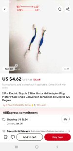

Hello
I saw some new items in alliexpress with the tittle:
E Bike Motor Hall Adapter Plug Motor Phase Angle Conversion connector 60 Degree 120 Degree
and wanted to know how they work... i think the middle sensor is inverted logic leaving the rest intact so if 0v is present then output is 5v and so...
is this right? should a gate ic not be used or with this simple circuit it should be fine?:
