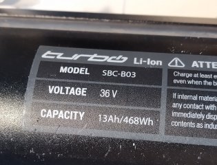

update:
build a battery 13S/7P 21700, cells, 1.5kWh, installed Grintech Baserunner&Cycleanalyst.
what do you think, are these (ball?)connectors (for motor, 3phase) good enough? i installed a 40A DalyBMS. i'd say no, but d phase-wires, which are supposed to carry 30A continously, are probably only 1mm2 too :unsure:

If they are properly crimped onto the wires, and the barrels properly fit the pins, securely, then they'll probably be low resistance enough for 30A phase current.
If they are not properly crimped, or don't fit tightly, there will be higher reistance than there should be at those points, and they may get hot, which could cause problems or connection failure.
I don't know offhand what your phase wire current limit is--remember that most wiring charts are probably for open-air conditions, and your wires are probably bundled up together inside a thermally-insulating jacket, so they'll get a lot hotter inside that than they would with the air passing by them as you ride, and so be able to handle less current.
If they don't get warm, there's nothing to worry aobut.
If they do, you can change them out. :)
The BMS current rating isn't relevant to the phase wire current.

yes, well crimped&tight. i know about d heat to be expected if connection is bad, but i can't check easily.
i would have thought rating is important, as it indicates max Amps to be expected? what i still don't know is how many A there are in d 3-phase AC-wires when i have 40A flowing from battery.
i also noticed only ~17A/850W max on d screen, although i was going uphill and had to help pedaling. i set limits much higher. possible these connectors are limiting current flow? anyway, i ordered MR-60 connectors to rule that out.
