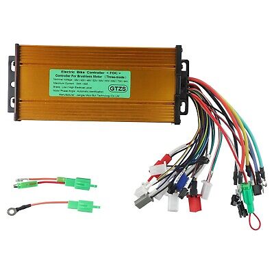

Lately, it's this:
Similar ones are available in higher and lower current ranges. They're extremely smooth, quiet, and easy to set up. The 60A one I had failed in less than ten minutes of use, but the two 35A versions I own have been faultless. If they are programmable, I don't know how that would be done. They don't support a display.
