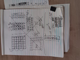

After drawing and thinking and playing with Lincoln logs and reading more and going nearly insane, I'm pretty sure I was on the right track at the beginning. Although it's not the most energy efficient way to do it, stacking up parallel cells in a tall ++--++-- line, then connecting the long strings in series is the only way to get everything into the space I want and have the power I want without adding $200+ in (cheapest) BMS's.
So, Knowing I'm going to end up with power losses from heat, I have an idea I'd like to throw out there. If I take my 10mm nickel strip, and made a nickel/copper/nickel "sandwich " with some 4mm or 5mm (? Not sure what is available?) Copper strip, would I then have something able to carry that 50A with no problem? I can't spot weld the copper but would the welds to the nickel up and down the sides pull everything tight enough to together so I wouldn't create an even worse situation?
I'd also like to know the answer for future knowledge if this ever becomes an issue with higher amperage. I could avoid a bus bar for maybe even 75A
Your current battery uses 14 sticks. Each stick is your funky 5P arrangement, which is about 20mm in diameter and 320 mm long. That would mean your battery is roughly three groups of sticks in bundle, with 5 sticks in two of them, and four in the third. In terms of individual cells, it's 15 cells long and 5 cells in diameter.

Here is some of my insanity. 400mm tall x 120mm wide x 60mm deep. BMS is about 200mm long (without wires on ends) about 15mm thick and about 65mm wide

A big block like that is easy to build as a set of paralleled blocks that are then seriesed, which is much better / easier than the other method.
You have 6p sections you want, right?
Take 12 cells, 6 with + up and 6 with - up, in the same configuration you have the cells laid out now. Connect (weld up) a single plate across all of the cell ends that are on the bottom. That is your series *and* parallel connections for that group. That group is your end group, the most negative set, and the next group up. The unconnected negative ends of the first six stick up and are on the "corner" of the battery block. (these then get their own 6-cell plate to parallel them and make your battery-negtive connection).
Do that again, and fold that between the two sets of cells, so the plate is now held between the two, with their + and - ends facing each other. This is your next two groups. Repeat this left to right right to left for the rest of the stack, as in the really crappy paint image below.
The "BMS slot" would be on one end instead of along the side, if that still works for your configuration.
Pretty sure you can even buy premade nickel plates to do this.
eidt--battery hookup sells ones that have percell fusible links NICKEL FUSE 2P-6P WIDE CONTINUOUS ROLL BY THE FOOT! 18650 CELL LEVEL FUSING
and plenty of other versions are out there too. For your purposes the ones that are solid like the above will be better than the ones that are cross-strip types like these

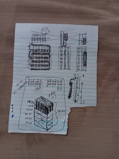

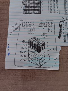

That was my absolute first attempt before I sat down with a ruler and some extra thought, but I'd have to shave about 8mm from the interior of the hole to fit the bms. 60mm is the actual hole opening (giving me only 1mm before/in-between/after wrap and the 3 cells. I don't know how I could grind that much away evenly considering the hole is not removable from the bike and can be accessed from just one end. I did build one like that from rough measurements before I realized how critical even 2mm was in the overall scheme of things. I have considered blowing both sides and the bottom off and building whatever I wanted and THEN building the frame around it but I don't know how to weld very well and people I do know that can do it are...let's say...unreliable. The measurements I wrote are dead accurate to the mm. Any 0.Xmm is lowered to the prior mm. This is a tight fit. So much so that I'm adding 4) 80mm fans to the hole. 2 for air entry and 2 for evacuation. This entire thing is an experiment for me to learn more

How about something where the BMS goes in after the battery, separately, but still wired in? Then secure it down with velcro or some other fastener so it doesn't bounce around and get disconnected or whatever.
Or a 2-part battery with a simple plug-in connector interface for a single series connection between them, with the BMS as part of the first one that goes in, and a connector for the second half's balance wires to plug into.
There are probably other schemes similar to the one I posted that would still get you minimal amounts of high current interconnects, doing as much of them as possible just like in that scheme. The simpler the interconnect and packing scheme, the easier (and usually cheaper) it is to make the connections and the less risk of problems from them, and the better the performance is.
Not being there to see the actual parts involved, including the space and shape and what not is much harder to come up with solutions for. Sometimes there is one that just involves thinking outside the box, or forgetting there is a box, or not realizing there is a box, all of which I have done intentially or not. ;)

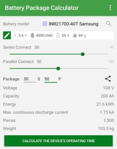

Since my end goal is creating a road legal motorcycle built from a sport bike frame (registered) and having it outperform most others on the market (the best I've found commercially is a 24kWh 134mph bike [in sport mode] with 155 miles of range in standard mode. I'd be happy with 80% of those (most likely false) stats, I'll look at and attemp to wrap my mind around your suggestions. Run on sentence included at no additional charge.
That battery is going to weigh over 200lbs, almost double the weight of an R6 engine, if you build it with 18650 cells, and there’ll be ~2000+ cells, or 1100 21700 cells. I’d double and triple check each of the 4000+ spot welds so that one bad weld doesn’t ruin a pack with $7k+ of cells.
An r6 engine reportedly weighs in the neighborhood of 100lbs. Based on my battery calculator 21700 cells would weigh about 100kg. So 45 lbs? Not sure. Either way, lots of busbar weight plus controller(s?) Wiring, supports, gonna make it heavier than just cells. Distribution of the weight will probably be difficult to avoid becoming top heavy. It's definitely a goal but one that has been done by industry. I'd like to think I could come in under 25k
100kg is 220 lbs.
