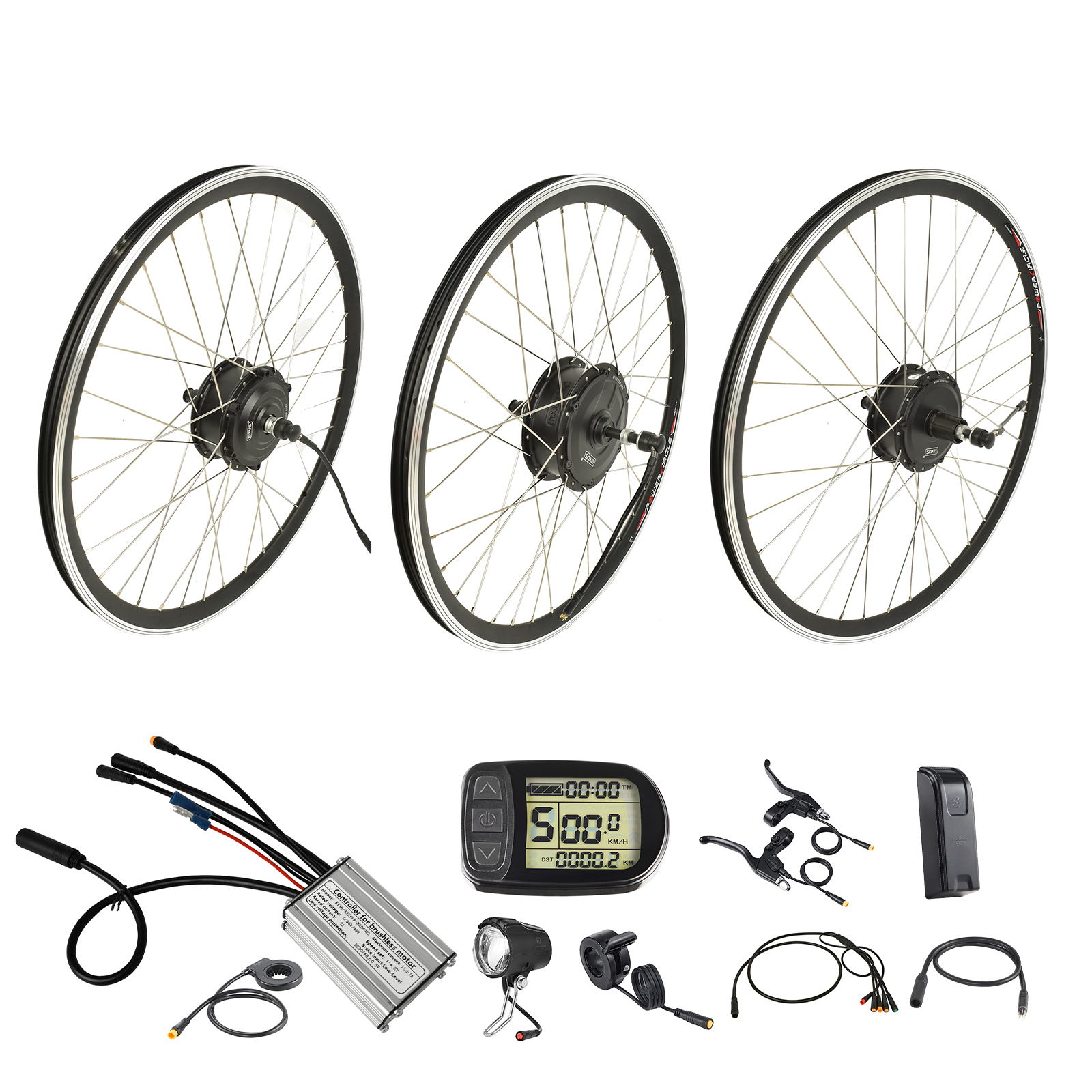

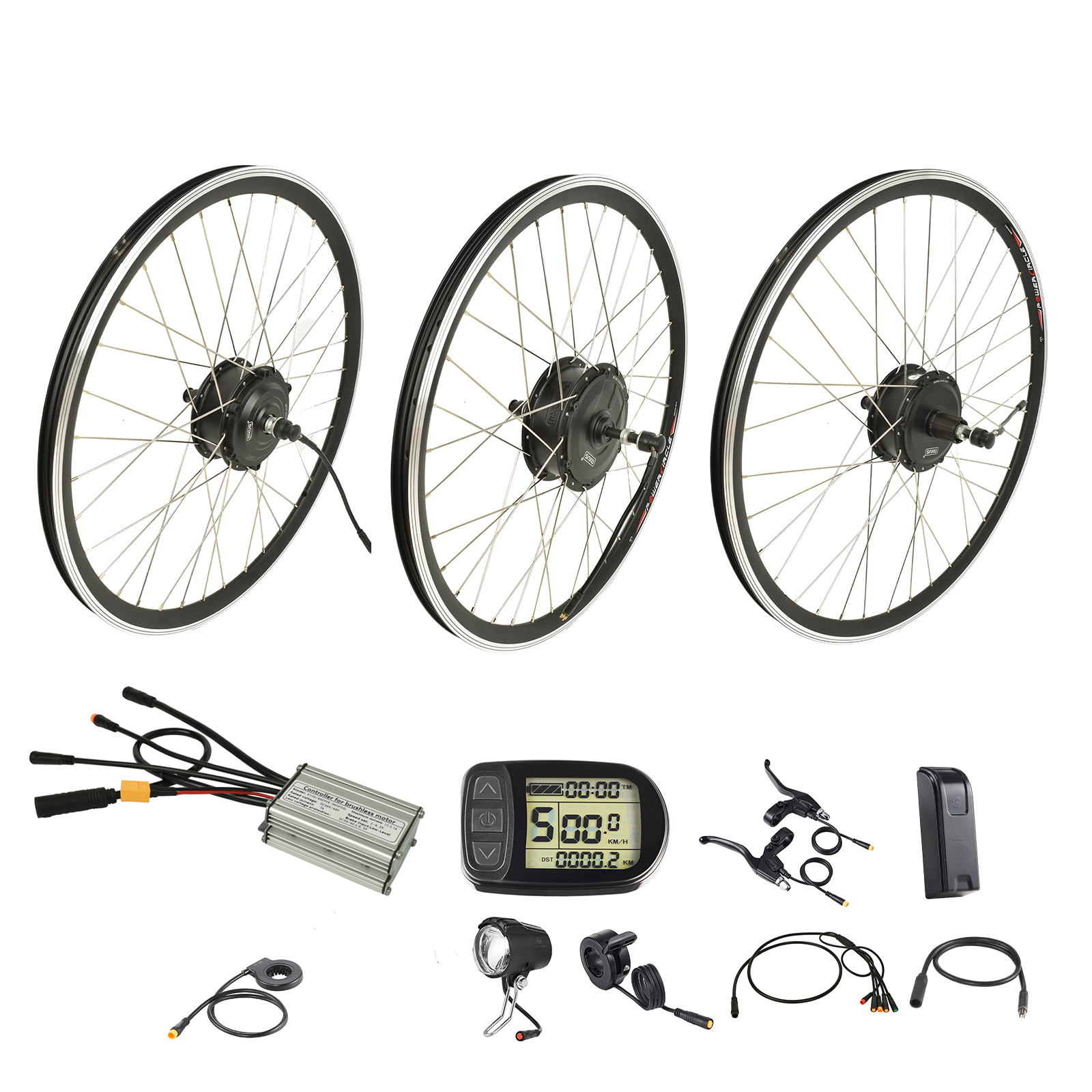

They probably changed the controller with the new type of motor.I belive the earliest had a bafang 250w cst motor,mine had Dapu m155 motor.Screw on motor cover.Very good low end torque.The latest have another type of motor with a bolt on motor cover.Looks like a Bafang swx02 motor or copy.I also had an ebike kit from Woosh with the Swx02 motor which run fine on 48volt 18 amp if thats what you got.
