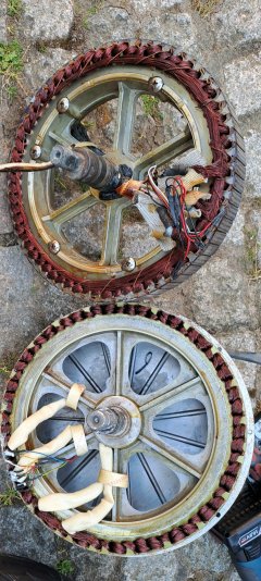

Last year I upgraded to a QS273 10kw Motor with a faster winding getting me to 125kph without field weakening.
This motor runs much cooler and has much more tourque but needs a bigger controller.
This motor has also a higher efficiency , I did a 150km motorway travel and at the end of it I still could easily stay behind the 97kph truck.
An 8kw motor will shure be enough, but I wanted my scooter to accelerate like a 400ccm motorbike.

The 5kW was installed in my first scooter with a max 5kW controller and stayed always cold. I swapped this motor over to the bigger chassis from the Masini Extremo and pushed it up to 22kW before i changed to the 10kW. The 8kW motor from the Masini Extremo looked weaker to me, later I found 5mm wider magnets and less copper in the Masini Motor.
The Masini motor was wound for 20% slower but it had more tourqe.
