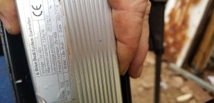

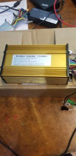

I got home and recharged the battery, pulled to cover off and checked all wires for burns or short, all is good with them. But the motor stutters and can't make power. This is the controller, it appears the adhesive on the label got soft and the sticker bubbled up a bit too.

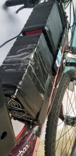

Pictured below is the dual battery array, at the lower left of the image is the controller cover.
