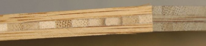

Just to prove that I am more depraved than the average bear, I also considered cutting the bottom stays out of a piece of solid 1-1/2 inch thick bamboo plank (actually it is two pieces of 3/4 inch plank laminated together). That is a somewhat expensive (but possibly more practical) solution as a single piece of bamboo plank 3/4 thick x 12 wide by 48 long runs nearly $100 with shipping.
Reference: https://www.woodworkerssource.com/shop/product/BAM44.html
View attachment Bamboo Bike - Plan A- All.pdf

I total agree with your assessment on both counts. It would be much better to have the plank made of layers with alternating directions for the grain to eliminate the tendency to split. I found something like that on EBAY: Solid Bamboo Three Ply plywood, 30"x11.5"x1/4" Bamboo Xcross 799.jpg http://www.ebay.com/itm/302017571371?
It is less expensive as well. I figure several of these could be laminated (epoxy) together, perhaps with a bit of carbon fiber cloth between the top and bottom layers for added strength. With a 1/40 bamboo veneer on the edges it would be hard to distinguish it from a sold plank.

Perhaps a bit too strong and heavy as well. I am back to using straight 1-1/4 tonkin bamboo with the laminated planks for braces. My very short (four inch) header tube necessitates a bit shallower top tube angle. I am reworking the dropout design to accomidate that as well as eliminate the possibility of chain rub. The good news is I am considering a two piece design that allows the angle to be changed. It might even allow for a gates belt to be installed.
