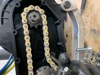

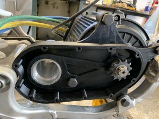

Qs180 90h motor With reduction chaincase but this time in an oil bath because on the other bike the chain was getting hot.

What sprockets do you plan to use, and how will you tighten the chain?

Im using a 11 tooth 428 size for the motor side and 16 or 17 on the jack shaft. The will be a chain tensioner in the chaincase like on a snowmobile.
j bjork said:
Alright, have you found available 11tooth sprockets or will it be custom made?
I bought 17 tooth JT sprocket that have the right spline and I will be turning it on the lathe just to keep the spline and weld to 11 the other 11 tooth sprocket.

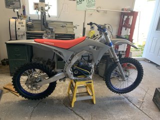

I made some progress. This build will take time since I did not buy a roller frame instead Im buying parts to make the bike. The motor mounts are done
The final desing of the chaincase is done. 3d printed to see fitment.
What took a lot of time was fitting the alta front forks and the rear shock.
machined a new steering stem and rear shock mount.
now it start to look like a motorcyle.
